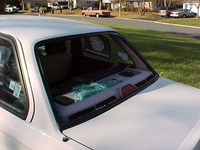

                        Here's what it looks like with no glass: :D

                              Nope, no adhesive - very easy. After watching the guy install it, I felt like kicking myself for actually paying someone to install it. Particularly since, as you can see from the picture, I had no back glass to take out. Half the job was already done.
