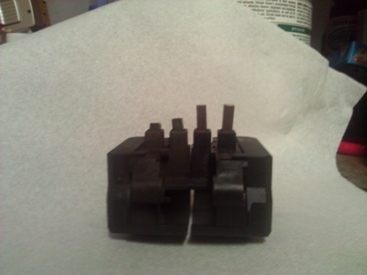

    In my E30 all lights are flickering. I already tested alternator, Voltage regulator and battery is new (only 2 week old). One thing I noticed is lights are flickering when car is idling or when in neutral. When car is in gear and moving no flickering issue.

              Sounds like a voltage regulator problem to me. I'd start there since it's a pretty quick check. Might have to take out the air box. I swapped in a new regulator about a month ago after experiencing bad light flicker. Problem solved. My old regulator was toast.
