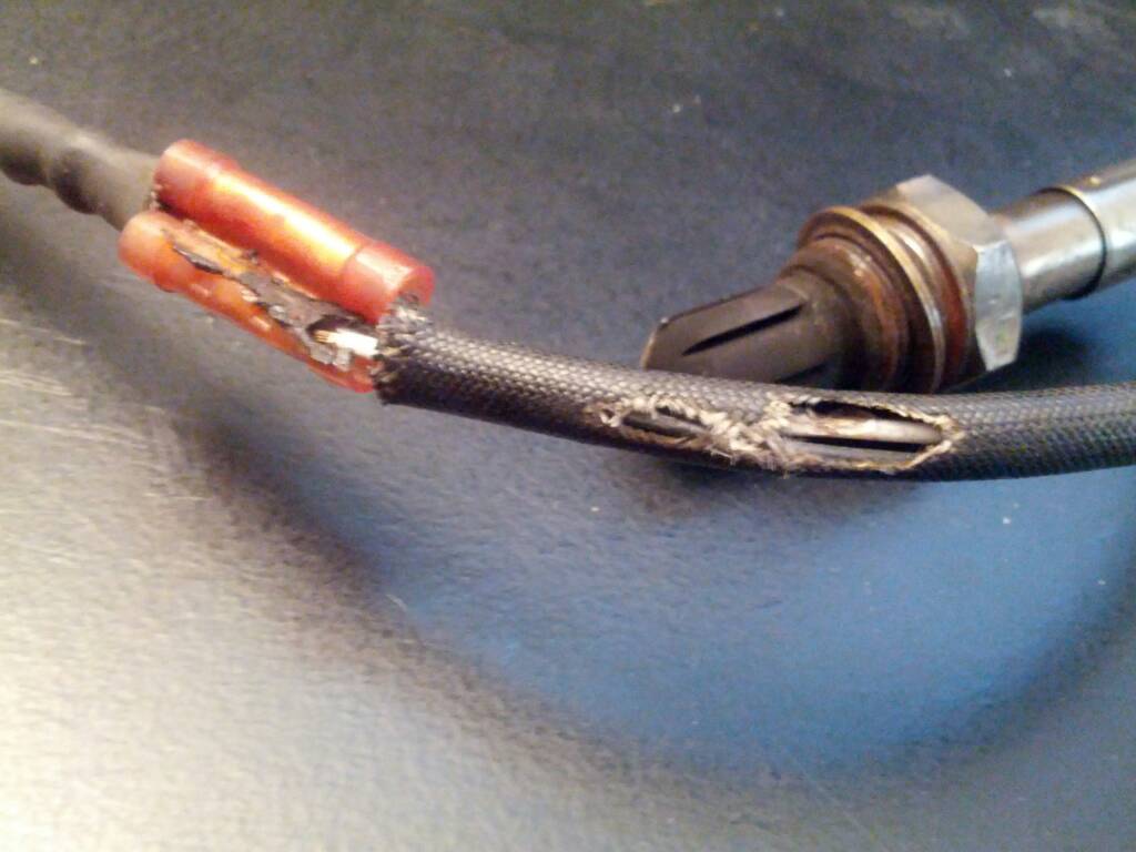

                • Andr3w
                  • Feb 2011
                  • 71
                  Think I found the issue
