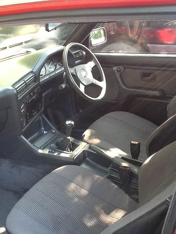

        are your pictures reversed or is this a right hand drive car? the glove box picture is throwing me off.

          Sorry I forget to monition the car is a rhd, I shipped it from England to the US. I know the b25 engine run’s the distributor off the cam but that’s what's got me confused. Is the distributor on its own harness like the b20 or is the b25 hard wired into the harness.
