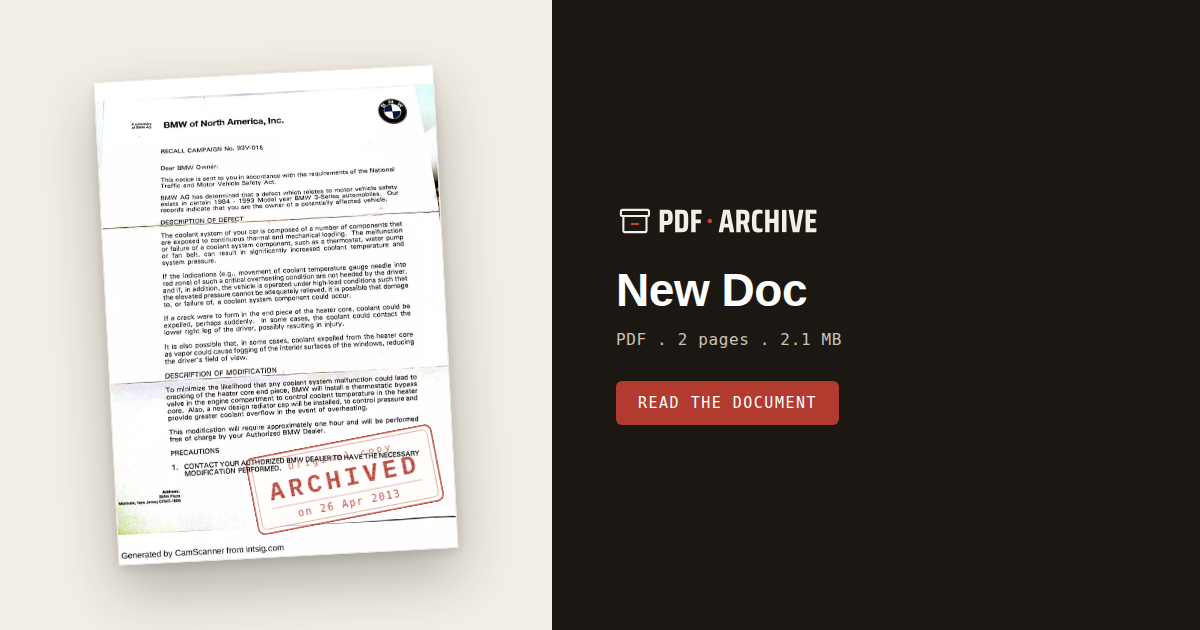

          Scanned this for those interested in official BMW NA recall letter sent out to the owners in the late 90's.
          PDF file BMWe30coolantrecall (PDF) by CamScanner - Download PDF file bmwe30coolantrecall.pdf (PDF 1.3, 2.1 MB, 2 pages)
