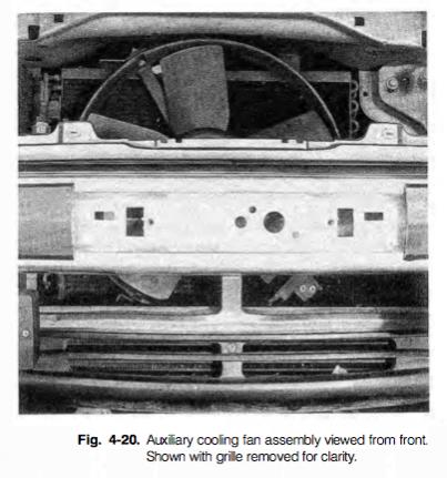

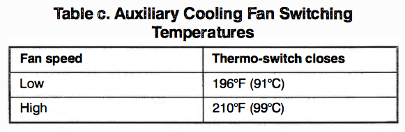

                        For greatest safety, cooling fan and thermo-switch tests should be performed with the air conditioner off, and preferably with the engine cold. The tests below simulate a warm engine by electrically bypassing the thermo-switch with a jumper wire.
                        Switching temperatures are given in Table c. [ATTACHED]
                        Remember that the radiator thermo-switch will only turn on the electric cooling fan when the coolant temperature is high enough to close the switch. If a faulty thermostat is not allowing the coolant to bypass the radiator and warm up to the switching temperature, the thermo-switch will not close and the cooling fan will not run.
                        NOTE-
                        A temperature gauge which is not indicating normal operating temperature may be an indication of a faulty (stuck open) thermostat.
                        In addition, the fan will not run and the engine will overheat
                        if a faulty thermostat or a plugged radiator will not allow hot
                        coolant to reach the switch. To quickly check that the thermostat is opening and that coolant is circulating through the radiator, allow a cold engine to reach operating temperature (temperature gauge needle approximately centered) and then
                        feel the upper radiator hose. If the hose is hot to the touch, the coolant is circulating. If the hose is not hot, either the radiator is plugged or the thermostat is not opening.

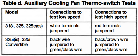

                        If the coolant is circulating at normal operating temperature and the auxiliary cooling fan does not run, test the fan as described below. Disconnect the radiator thermo-switch connectors and use a jumper wire with an in-line switch to bypass the thermo-switch and simulate a switch closed by warm coolant temperature. Test the fan with the ignition on.
                        CAUTION-
                        Connect and disconnect all test leads with the ignition off.
                        TABLE D ATTACHED on next post
                        WARNING-
                        Always keep hands and wires clear of the fan blades. The cooling fan may run at any time the ignition is on.
                        NOTE-

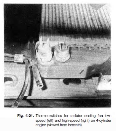

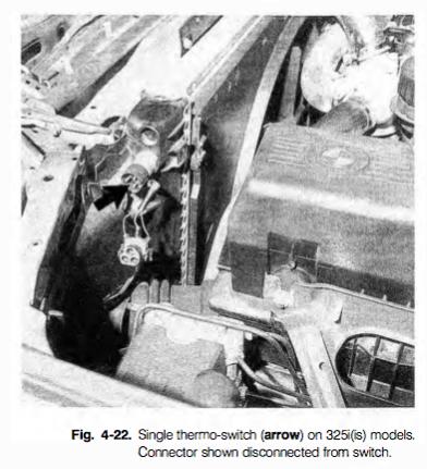

                        On 318i models, the thermo-switches are located on the lower left-hand (driver's side) corner of the radiator as shown in Fig. 4-21. [ATTACHED] On 325 and 325e(es) models, the thermo-switches are located on the upper left-hand side of the radiator. 325i(is) models use a single thermo-switch combining both switch functions in one housing, also located on the upper left-hand side of the radiator. See Fig. 4-22. [ATTACHED]
                        If the fan runs only when powered directly by the jumpered connector, the radiator thermo-switch should be replaced. Torque a new thermo-switch to a maximum torque of 15 Nm
                        (11 ft. lb.). Inspect the thermo-switch gasket ring whenever the switch is removed. The gasket should be replaced if it is crushed or otherwise damaged.
                        If the fan does not run when powered by the jumpered connector, check for voltage at the connectors. Measuring between the green/black wire and ground, there should be battery voltage (approx. 12 VDC) whenever the ignition is on. If not, check fuse no. 19 (7.5 amp) in the fuse/relay panel. If battery voltage is reaching the connector, check the high speed relay fuse no.
                        18 (30 amp), and the low speed relay fuse no. 3 (15 amp).

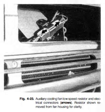

                        If the fan runs only at low speed, check the high-speed fan relay (position K6). If the fan runs only at high speed, check the low speed fan relay (position K1) and the low speed resistor. The resistor is mounted to the auxiliary fan housing, behind the center of the front bumper. See Fig. 4-23. [ATTACHED] Test the resistor by removing its electrical connectors and measuring its resistance. If the resistance is not approximately 6 ohms, the resistor is faulty and should be replaced.

                          table d
