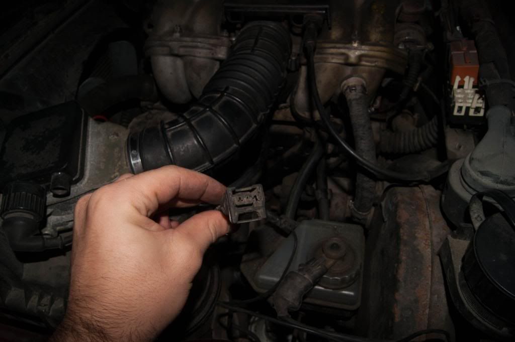

                          Ok, it's update time.
                          Put a fully charged battery in, nothing happened, battery light was still on when the key was turned. Primed the starter and the starter turned with no problem. It seems like somewhere there might be something disconnected as there is simply no current going into the starter motor.
                          I did find disconnected cables in the car and under the hood but I have no idea if those should actually be related.
                          The first photo shows the disconnected cables under the dash, the second one shows a disconnected plug with cables going into the engine and the air filter.

                            With a fully charged battery in the car (one that reads 12.7v) if the starter fails to turn the engine there is a problem with the primary power/ground connections, a problem with the starter solenoid control power, or a bad starter. Diagnostics would be:
                            Use a meter or test light to check for solenoid control power when the key is turned to start.
                            Use meter to see that primary power is present at the starter when the key is turned to start.
                            Use a meter to measure resistance from the starter case to the battery ground.
                            If those checks don't reveal a problem the starter is bad.

                              Sorted the starter problem, bypassed the ignition cable that goes into a relay, directly to the starter and the engine turned. It did not start but that's probably because I removed the alarm and the immobiliser kicked in.
