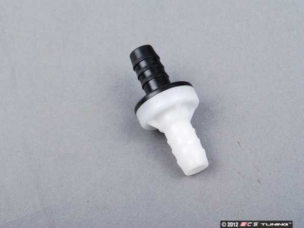

          ok i was looking into this. the hose from booster to intake manifold well there is the T fitting coming out of the booster then hose right into manifold. is that T fitting connected to the booster the check valve? or do i not even have a check valve?
          i did a little google research and it seems BMWs maybe have another check valve? or other car manufacturers include the check valve with the brake booster.
          but if its another valve in line with that hose going to manifold i dont even have one. something like this
          PS i did not do the swap, it looks like a pretty clean swap but just working out the kinks. thanks

                An E30 has the check valve in the hose connections.
                Jim Levie, Huntsville, AL
                • six2midnight
                  • 326
                  even late model? I have a 91. so check valve IS NOT connected INTO booster? because ecs tuning says diff?
                  http://www.ecstuning.com/BMW-E30-318...Valve/ES61684/
                  **says USED IN THE BRAKE BOOSTER ASSEMBLY**
                  if not ill buy valve from like an m50 setup and just splice it into that line and see if that fixes it.
