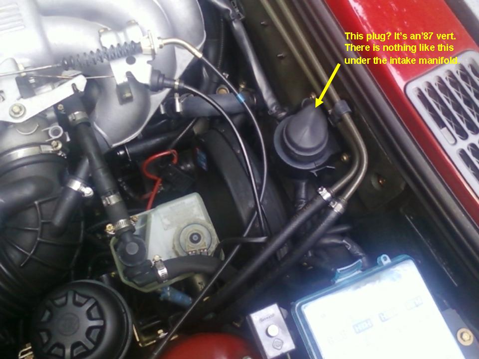

                      C101 plug under the intake, check it for corrosion. If it's corroded clean it to see if that helps. If it helps, then replace it with a weather pack connector.

                      • 510man
                        • May 2013
                        • 17
                        I don't have a C101 under the manifold. The only one I have is above the intake manifold by the thermostat housing. I opened that up and it's clean in indie. I've never taken it apart to clean it. Is that what you're suggesting or do some models have a C101 under the manifold?
                        • 603Racing
                          • Dec 2010
                          • 612
                          My bad, C191 connector. Commonly referred to as the "bitch plug".

                            Oh yeah. If original, the engine harness on this car does not have C191.

                            • 510man
                              • May 2013
                              • 17
                              I have this plug connector. I've never opened it up but some of the C191 pics I've seen using Google make me think I should check it. there is noting like this under my intake manifold.
