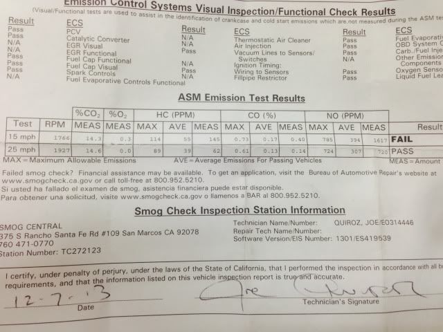

    Ok guys 3 more fails and I'm still lost.
    So far I now have
    -new cat
    -new plug wires
    -new plugs
    -new oriellys o2 sensor
    My good friends who is a respected tuner recently tuned my car and it runs better than ever. We used a sniffer to check and adjust the car to what was coming out of the exhaust.
    I changed the o2 sensor 2 nights ago and the plugs and failed again today
    We put the smog sniffer in the valve cover and it was sniffing tons of fuel in my oil. Problem is I changed my oil like 2 weeks ago.
    What can I do now? There is no PVC valve so what should I do now?

      Is the failure still high NOX? That would be the engine running lean or a bad catalytic converter. Have you had a smoke test run?

            There's the last test.
            • tightithrash
              • 200
              Cat is only a few months old.
              I should do a smoke test.

                  The only valve that you could have taped to the fender would be the evaporative control valve. The crank case vent on this car is a simple hose from the throttle body to the valve cover.
                  Get the smoke test done (and fix the leaks) and then have someone with a wide band O2 sensor measure the AFR at idle and up. It should be right at 14:1.
