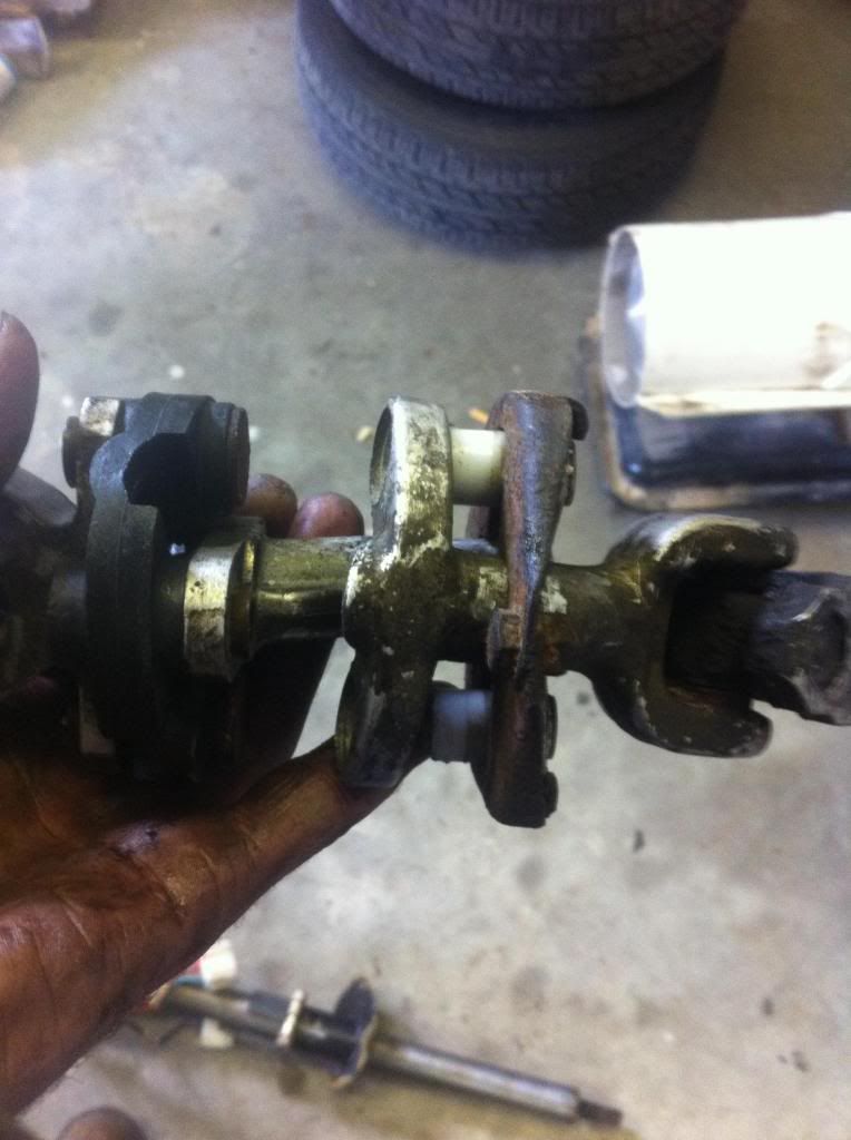

                      i took the linkage out and took a look and i found this.
                      im currently looking for a new one to replace this broken one.
                        If the u-joints are ok, there is a modification you can do to that one. Goto the diy section here and look up steering column. I believe you can remove those plastic sleeve pieces and replace them with some bolts and steel spacers. I have not done this but have seen it on some cars here on r3v. Read through it and decide if it's something you want to tackle.

                            looks like an accident
                              alright i have an update on this linkage. i found out that one of the U joints was stuck, i figured since i am pretty much going to buy a new one ill experiment. i put it in the vise and i sprayed it with penetrating oil to remove any dirt or crap. the U joint started to move a little better so i went ahead and sprayed some "all purpose" lubricant on the joint. it loosened up pretty well. i went even further and slapped some wheel bearing grease on it and it has no resistance what so ever. i would say it moves better than the over U joint.
                              im going to let it sit for a while and see how it feels in a couple days. part of me thinks its just an easy fix and another part of me thinks it just needed to be greased. any thoughts on this?
