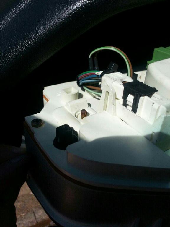

                    • Maad325
                      • Jan 2013
                      • 132
                      Well I think I found my problem
                      • Maad325
                        • Jan 2013
                        • 132
                        After fixing that missing bolt and tightening the other bolt the gas gauge reads quarter tank all the time and doesn't twitch. The temp gauge still only goes in between the cold and middle
