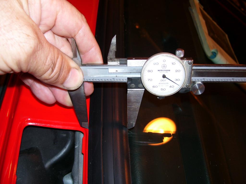

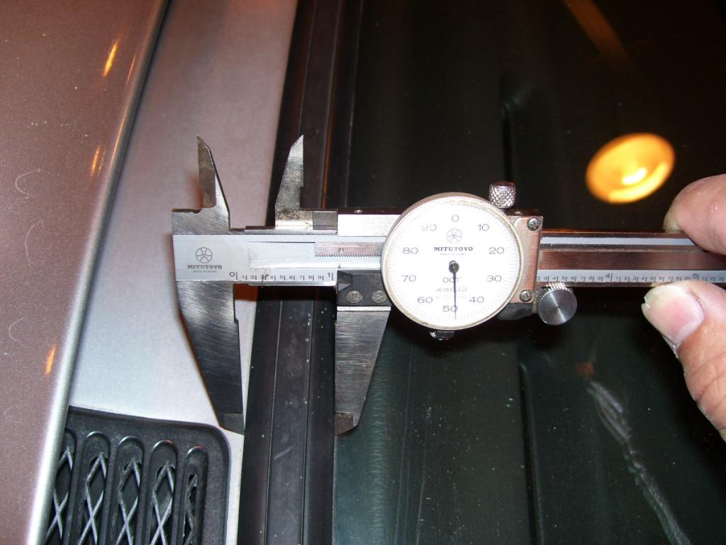

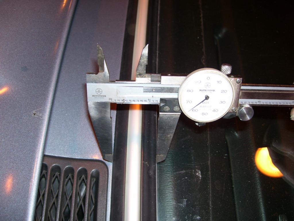

                I took some photos showing the variance in gasket width.
                Photo#1 = 1988 325is factory gasket (1.050" wide)

                Photo#2 = 1987 325e gasket 3 years old (1.260" wide)

                Photo#3 = 1987 325e new gasket by URO (1.430" wide)

                The variance is 3/8". I guess it's back to BMW and a OEM windshield gasket!

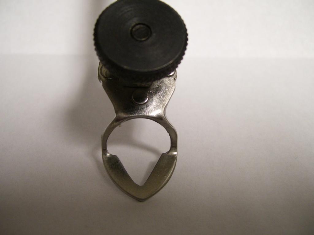

                          The windshield lockstrip insertion tool I use was purchased from Bav Auto. I had to modify it to get it to stay in the slot but after a little grinding, sanding and polishing it works great! As purchased if you did not keep pressure on the tool it would pop out of the slot, now you can even let the tool go and it will stay in the slot. I will post a photo of the modifications in the morning.

                            Bav. Auto windshield lockstrip insertion tool modification photo.
                            This keeps the tool from being pushed out of the lockstrip channel.

                              Not having one of these tools on hand to compare it to, I can't tell what your modification was.
                              What did you modify about it?
