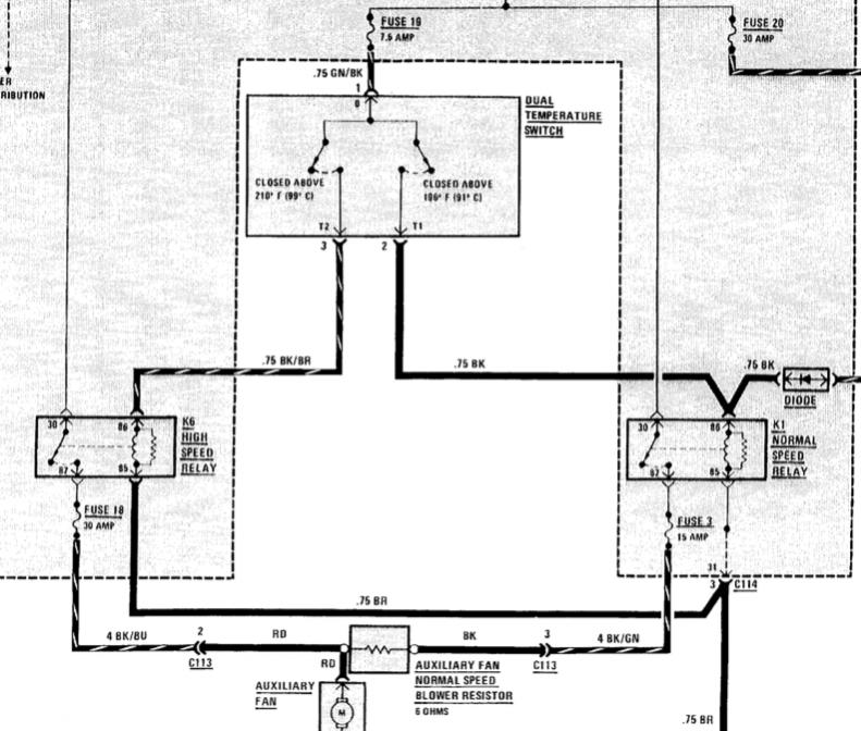

                And then I noticed this...
                So, I assume that black wire is supposed to go to the connector. I guess this explains my slightly erratic temperature readings. I think the black wire is just the sensor ground wire...but the green one looks like it is about to go as well. How should I go about repairing something like this?

                  Ok, so that is the dual temperature switch and it appears that the black wire goes to the normal speed relay.
