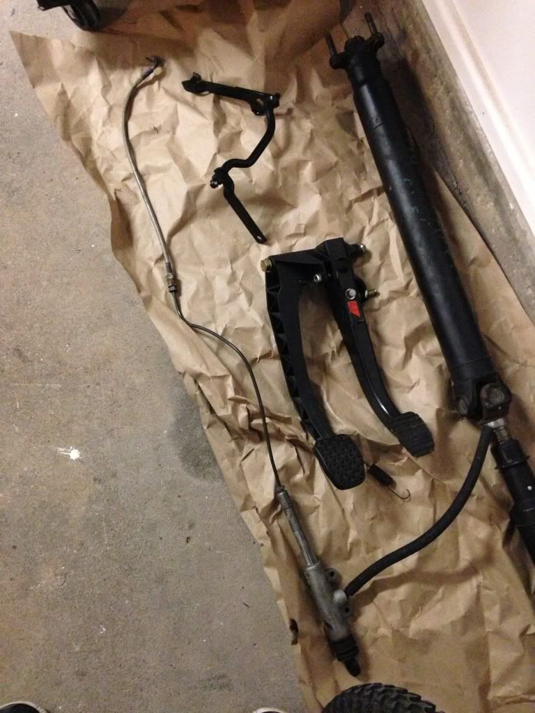

    Hey guys, i bought a manual swap kit and it came with just about everything, however i didnt come with the pedal box. Can i install the actual pedals into the automatic pedal box? Or do i have to get a manual pedal box? This is what i have.
    Thanks in advance!

    If its an airbag car, just swap pedals. The pedal boxes are the same. Its also a giant pain to remove (and uneccesary).
    Non airbag car, get a pedal box and swap it over. It just unbolts.
