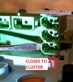

    When I took the instrument cluster out I did not see for sure where the single wire unplugged.
    I know that it goes in the green connector block that's under the speedometer.
    Here is the green block looking at it from the back with the cluster removed.
    [ATTACH]78500[/ATTACH]
    I think that it goes in the "bottom" one that the screwdriver is pointing to in the picture below.
    Does anyone know for sure which slot it goes into? {bottom, middle, top}
    What does that wire do?
    Thanks

    What's that wire even for? I just plug mine in wherever I can get to an haven't noticed anything wrong

      I don't know what its for.
      I don't want to put it all together then something like my cruise control doesn't work.
      The single wire can go into any one of the 3 slots.
      I hate when I do stupid crap like this.

          Its the speed sensor wire for the cruise control. You can plug it into any of the 3 slots, they all do the same thing.

            VP is correct, take your cluster apart and trace the lines (like I did) or just put a multi-meter to it and you'll see that you have continuity across all three.

              Uber Cool !!!!!!!!!
              Thanks for the reply.:o
              I'm dumb but its okay.
