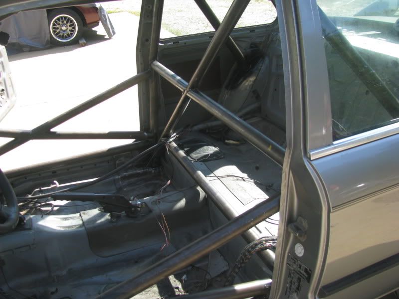

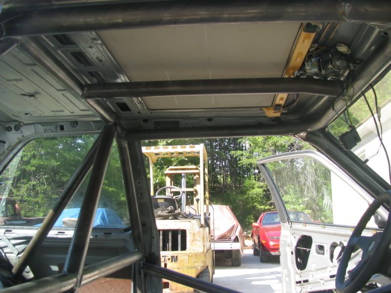

          I am in the same boat. Here are some photos rollcagecomponents sent me. Haven't pulled the trigger yet
          I asked if they can extend the bars to the rear towers, they said it wouldn't be a problem

            Kirk, based on those pics... That upper 'halo' design, in particular, will get you into
            trouble at an SCCA- rules based event.
            and if you have a 2- door, the Nascar bars sure are nice compared to the X.

                    @TobyB, how could that upper halo be changed on the rcc cage for scca events?

                      I don't know the SCCA rules, but I have my own problems with the RCC cage. The halo bar, cross brace, and rear braces need to all meet at the same point on the main hoop. The rear braces need to go through the rear bulkhead and terminate above the rear springs. The fender wells aren't strong enough.
                      The cage also needs foot protection and a dash bar.
                      One doesn't fully appreciate cage design/construction until they have experienced a high speed car destroying accident. After that you get real picky about the cage (and seat, harnesses, etc).

                        Jim pretty much said it-
                        the SCCA wants the 2 side bars to be one piece from the floor to the main (rear) hoop.
                        They DO have halo language, but I don't think they allow the misalignment Jim notes.
                        It's very dense, but the GCR is on www.scca.org under club racing, cars and rules.
                        Look at the ITB cage rules- they're a good 'more than a street car' minimum standard.
