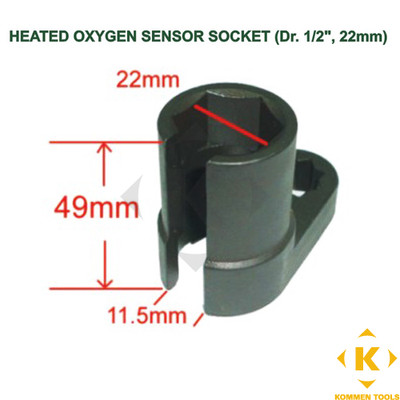

    Next time...

      That's a great tool to have. I just spent a lot of money on parts recently and was debating on if I should buy one or not but will for next time.

        There are very few tools I feel you have to have, but a ball joint press, an 02 socket and a fan clutch wrench set are very valued if you intend to work on your e30. There are others, but the headaches saved by those three are awesome.

          There is nothing better then having the right tool for the right job.

            I bought that socket the first time i heard "it needs an O2 sensor. Id buy it every time I had to replace one if need be
