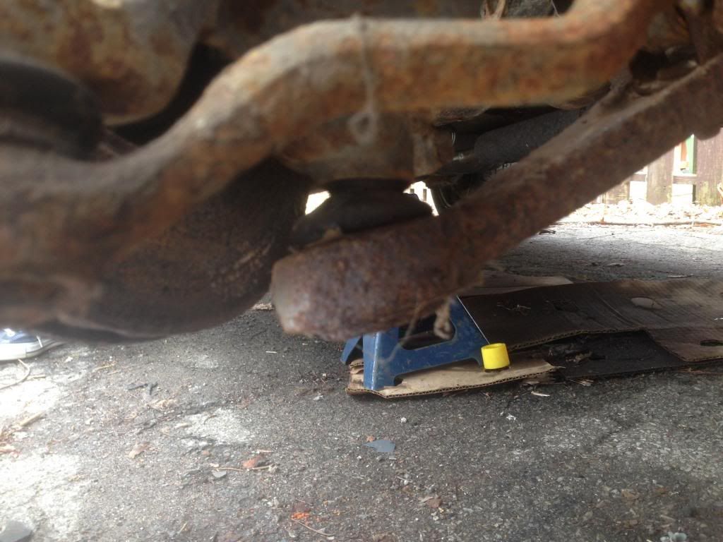

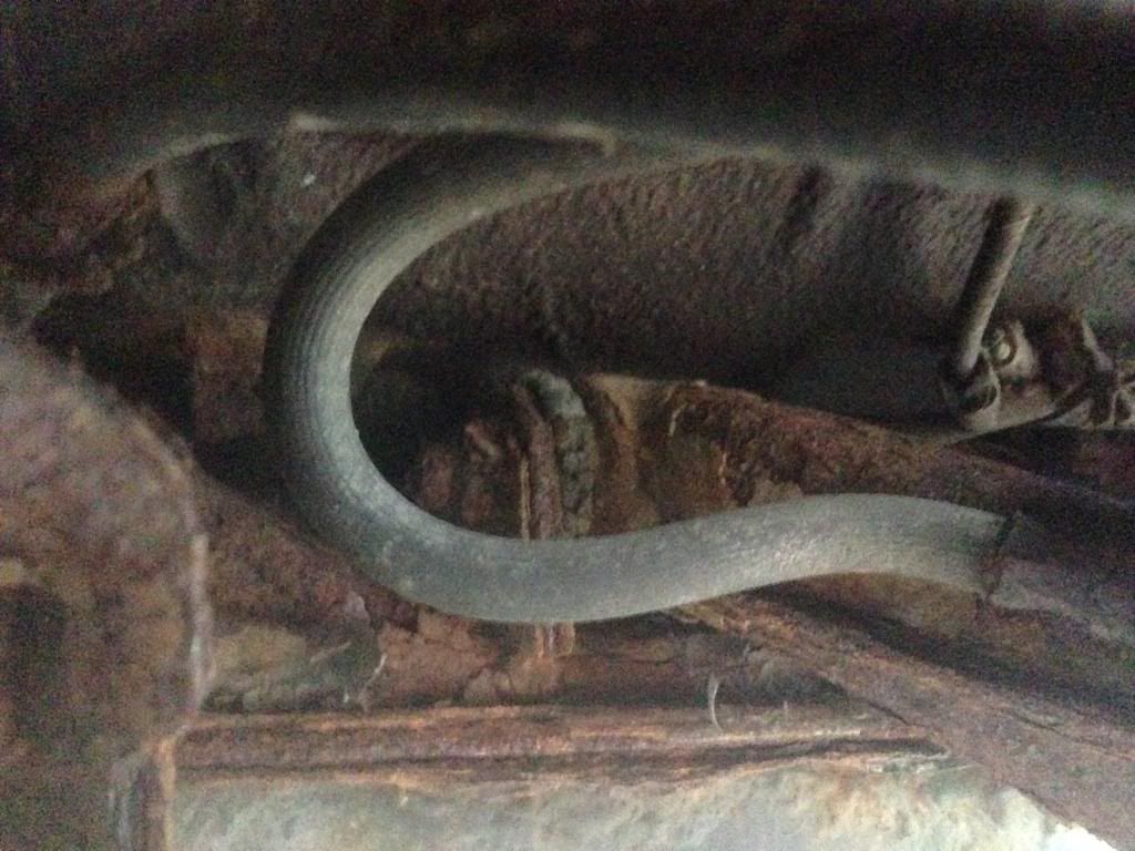

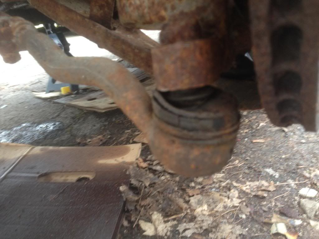

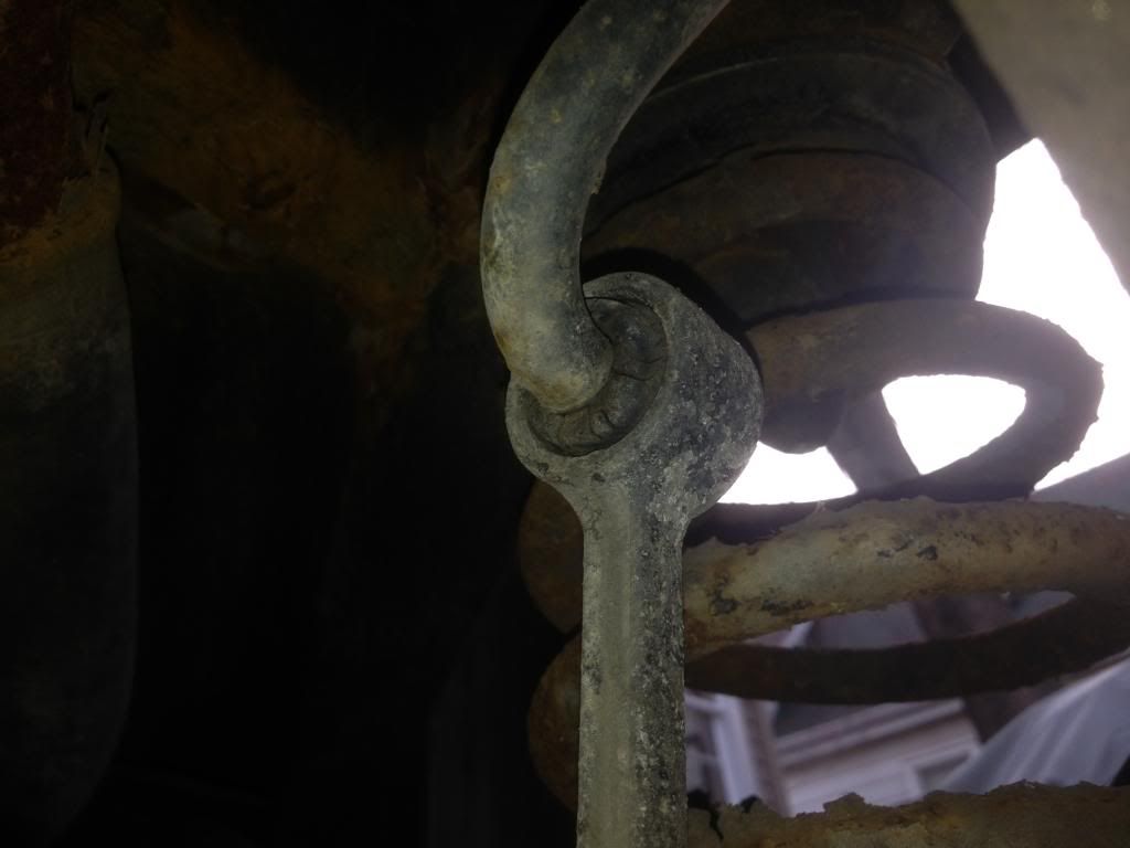

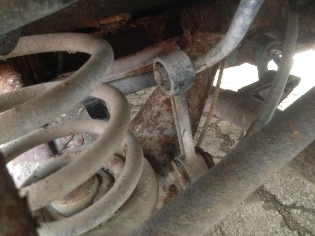

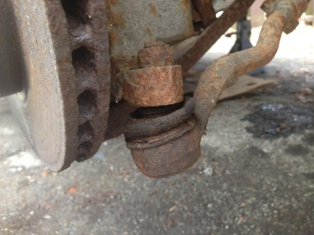

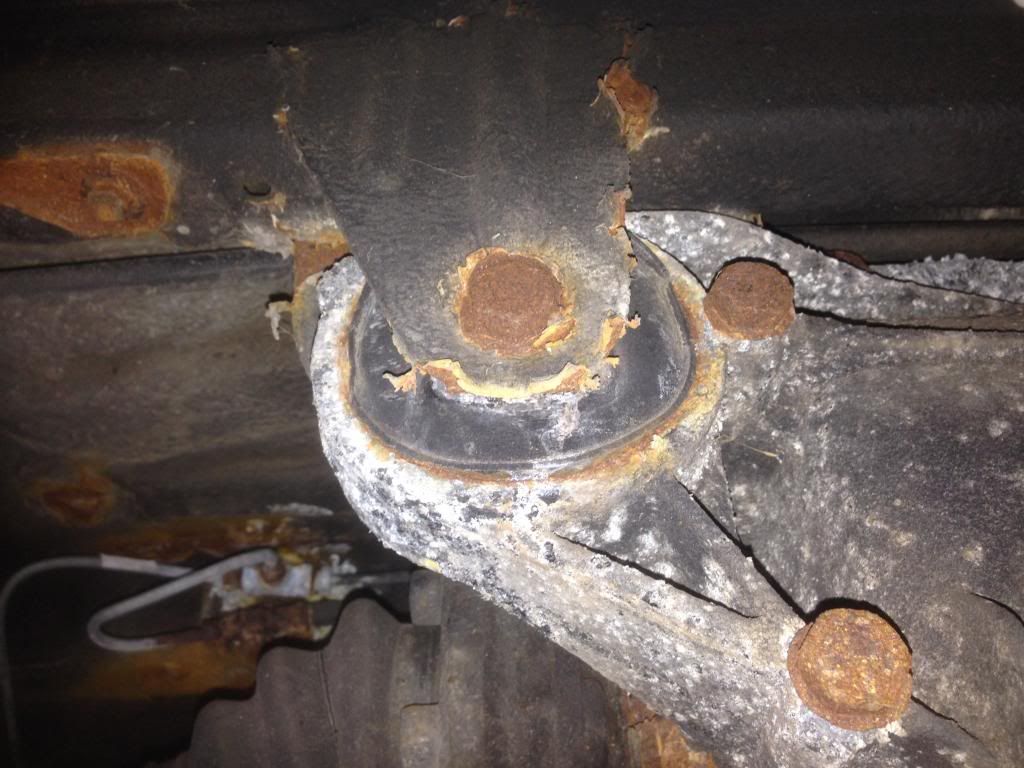

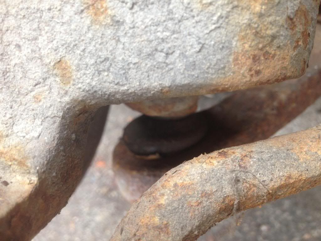

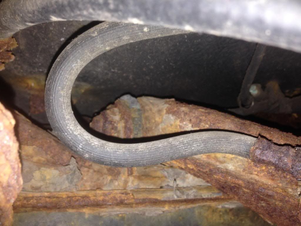

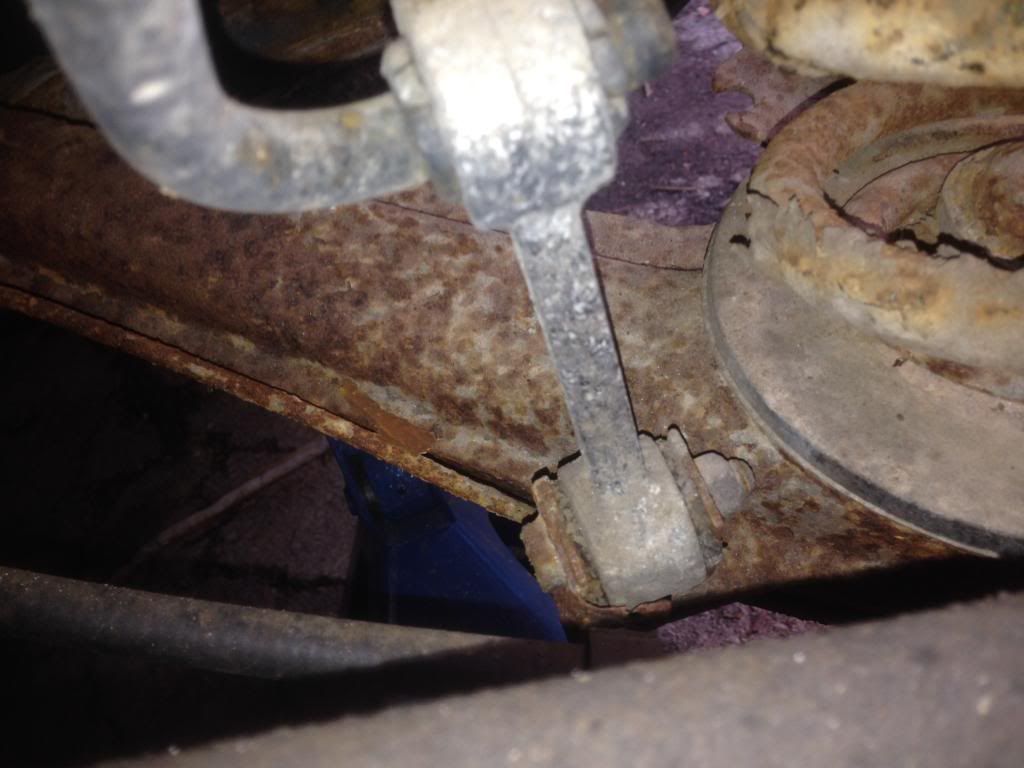

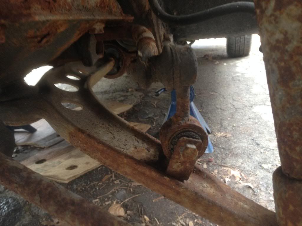

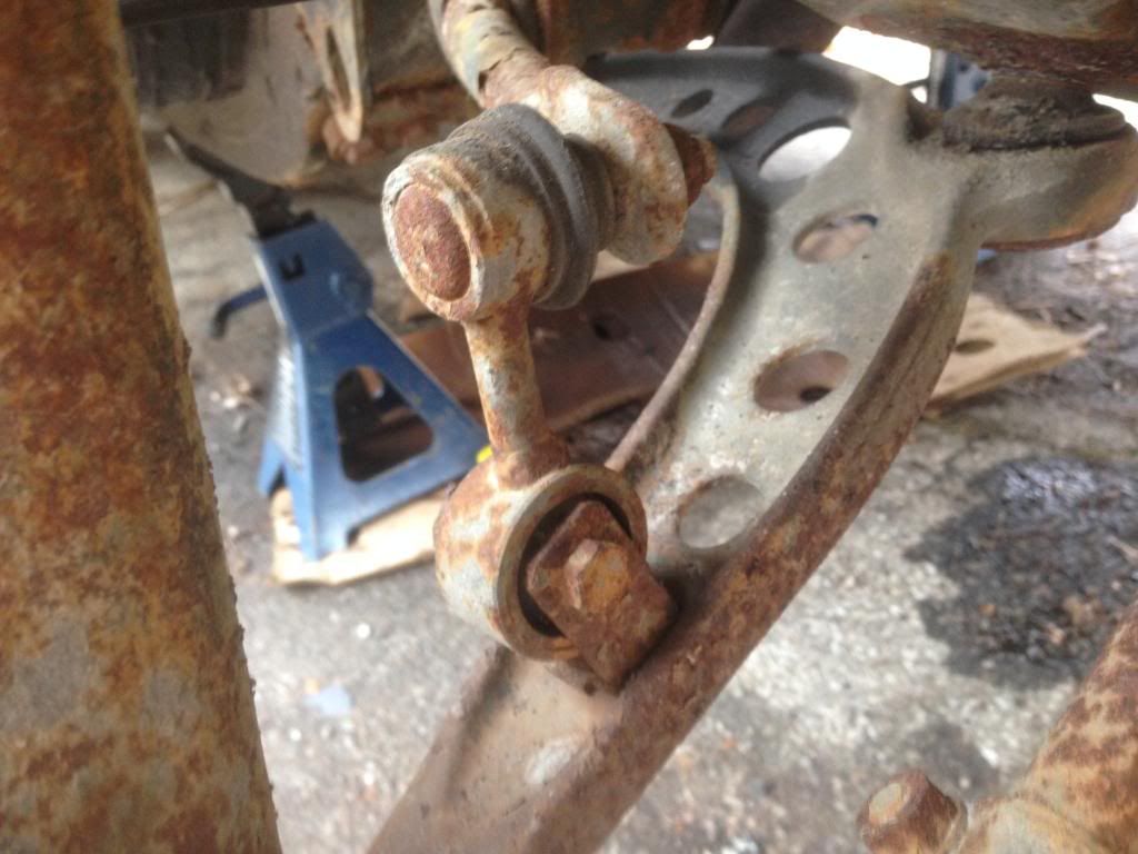

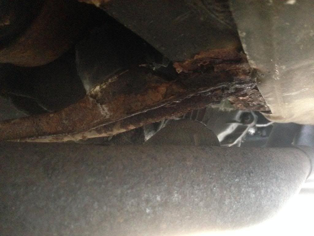

                Here's some pictures of all my bushings.
                Is there anything here that still looks usable? (rear diff mount?)

                  Wow, that all looks quite far gone. You might want to consider replacing the subframes, struts, trailing arms, transmission mount bracket, hardware and bearings.
                  I do wonder with all of that rust underneath if there is not rust hidden elsewhere. If there is rust elsewhere it might not be worth saving the car.
                    Good advice. I'll see how bad it is when dropped from the car, and go from there.
                    Pulling the carpets and dash next week to search for more rust.

                      Hory shit those bushings are wasted! Also, rust. My car hardly has any rust and I have to replace the brake lines... factor that in. Also, hoses.
                      Buy a spool of coated brake line and just do it all yourself. Significantly cheaper that way.
                      Also, polyurethane bushings can be had in soft forms.
                      *EDIT*
                      I think that's one of your brake lines running along the control arm in the second picture from the bottom... that bitch is real rusty. Definitely do the lines.

                        Are you SURE that your car is safe to drive with that much rust? I am afraid to find out and it is not even my car.

                          I'm not sure. That's why I'm not driving the car until I've addressed everything. :)
                          • blunttech
                            • 12850
                            Man I would not wanna drop that rear subframe. Ive done a lot of cars that didnt look half that bad and they needed all new brake hard lines. allow yourself some time and you may be ok. Im from the rust belt too and many times when a cars that bad you cant even get the strut inserts out as the tubes are so far gone. Good luck though.
                              I suspect your right, and I'll end up running all new hard lines. I'll soak all the bolts I need to take out for a few weeks ahead of time with PB blaster. Worst case I can cut them or drill them out.
                              Thanks for the luck, something tells me i'll need it!
