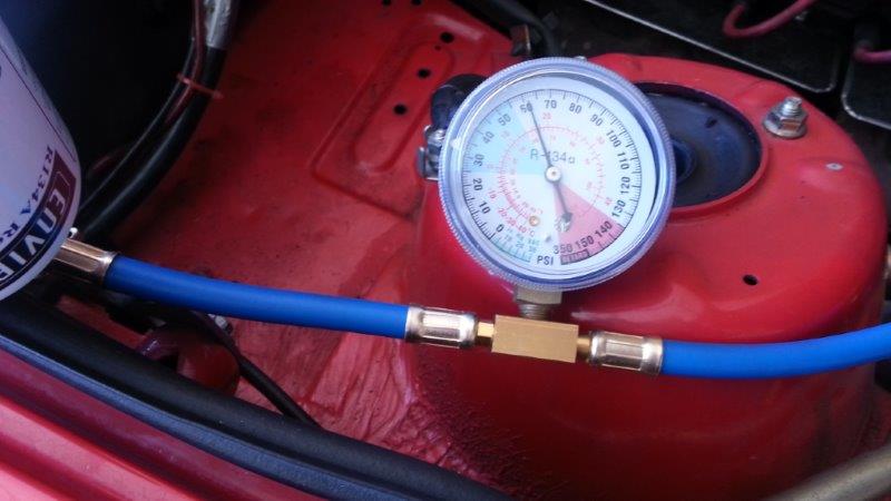

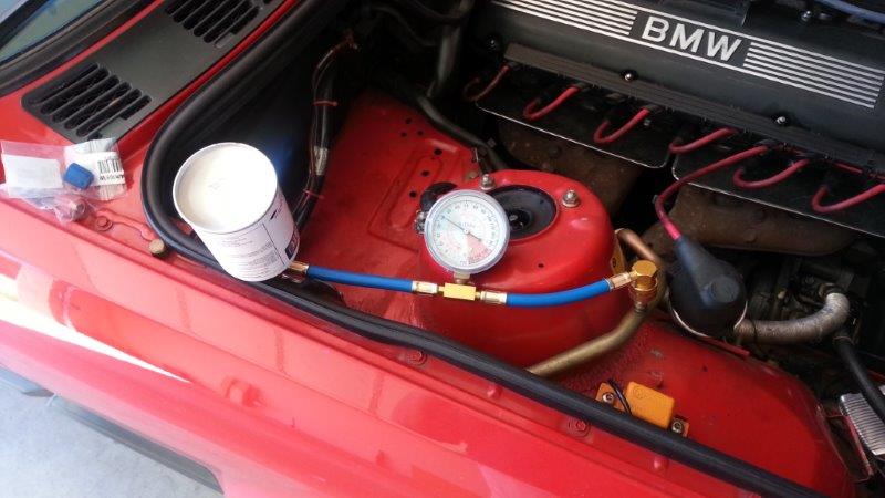

                    Got it and tried it out today. My temperature started at 70 degrees from the vent and 1 can of stop leak, 2 cans of refrigerant later it stayed at 70 degrees. Before I use my last can I thought I'd ask...
                    Gregs///M am I doing something wrong? Here's the port I hooked up to it's the low side right?

                    I couldn't figure out the pressure either. From what I found you want 20psi on an R-12 system. Or 40 degrees on the 134a scale. Mine was up around 60psi the whole time.
                      [ATTACH]85606[/ATTACH]
                      [ATTACH]85607[/ATTACH]
                      uhh overcharged?

                        Yea logically I would think that but that would mean it was over charged when I bought it? Could be. But the sight glass looked like it was under charged.

                          Originally posted by Jaxx_
                          uhh overcharged?
                          so can someone verify 20 psi is correct? I can't believe I'm that far overcharged.

                          • Hoffbrohaus
                            • Sep 2013
                            • 519
                            Pelicanparts.com article says 40 - 50 psi

                            • Jaxx_
                              • Dec 2009
                              • 1880
                              Sent from my SCH-I605 using Tapatalk
                              sounds about right. I could be mistaken, but charging shouldn't technically be done by low-side pressure. Instead, it should be done by weight.
