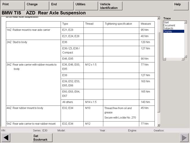

    I couldn't find it in the Bentley (or maybe I'm just dumb), but what is the torque of the large nut for the subframe?

        If it's M14x1.5mm then 140 Nm or 103 lbs-ft. Or braaap! brap! brap! But, what if you only do braap! brap! brap. Then 300 miles down the road, ka-chunk, ka-chunk, hmm, wtf is that noise?

                            M14x1.5, TIS says 140 N-m. Or 103 lbs-ft. Check out section 3AZ on the attached image.
                            Anyway, this is not a super critcal measurement, and putting your weight into a 2 ft cheater bar should be enough. This is an E30, not the Space Shuttle. :D

                            Stu, I think you're thinking of the front hub collar nut. That requires 210 lbs-ft. But it's way bigger than the subframe nut.
