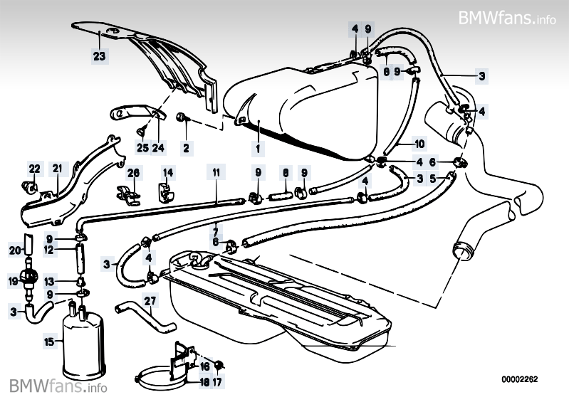

                        What is the hose on the fuel pump/sender that I cut, what part do I need to order?
                        sigpicMy Project!
                        Official North Texas Bimmers Club E30 Representative
                        www.BimmerAlliance.net
                        "If you have questions about events or need help in the DFW area don't be afraid to contact me."
                        • roguetoaster
                          Biggus Tippus
                          • 7830

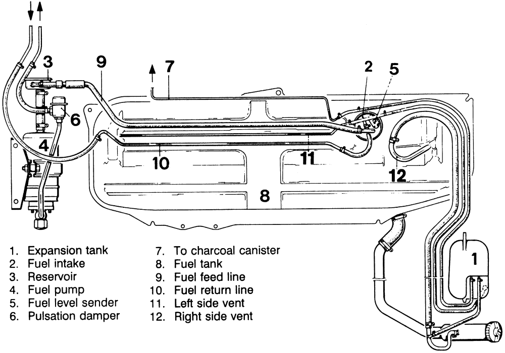

                          That's one of the vent pipes, and it connects to the vapor tank by the fuel filler door. Should be easy enough to find on realoem or bmwfans.
                          • bigdrick323
                            • Feb 2012
                            • 616
                            Is it #5 I really can't tell, these pics suck.

                              I was referencing number 5 in the second picture.
                              Unless there some other line you cut that I am not seeing.
