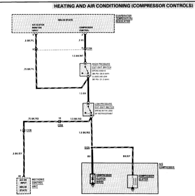

    This info is relevant for cars that came originally with two pressure switches (I think is pre 1989)
    (I kindly ask more experienced forum members to correct me if necessary).
    Alright, so I just did my r134a conversion on my ‘89 325i following the BMW TIS. I got the new high pressure switch (64538390971) with the new dryer (64538391025), replaced o-rings here and there, and changed the oil/lubricant in the compressor. However the pressure switch splice deal is not clearly explained in the TIS.
    The TIS says you should cut and join the cables from one of the pressure switches but it does not specify which or how. Here is what I did.

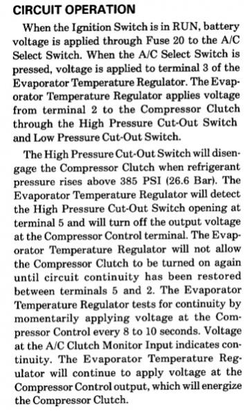

    Please see the attachment which are the electrical diagrams and explanation of the circuit for the original set-up.
    ORIGINAL SET UP
    The cables that go to the high pressure switch are three:
    1h. Black with white stripe
    2h. Black with yellow stripe
    3h. Black
    2h and 3h go together at the connector
    The cables that go to the low pressure switch are three:
    1L. Black with Red stripe
    2L. Black with Red stripe
    3L. Black
    1L and 2L go together at the connector
    CONVERSION SET UP
    • 1h, 2h, 3h are ALL soldered or crimped together
    • The new high pressure switch has two cables, one connects to 1L and the other to 2L+3L (through a connector).
    The rationale is that by doing this the old high pressure switched is eliminated and the new high pressure switch replaces the old low pressure switch. In this way the A/C Clutch Monitor Input and the Compressor Control remain connected to the rest of the system via the new high pressure switch.

        Wouldn't wiring the switch per your directions either result in the Motronic Control Unit or the A/C Compressor receiving power independent of the cut-out switch position depending on which black/red wire (either 1L or 2L) are connected to the black wire (3L)?
        Shouldn't the wiring be: 3L to one cable from the cut-out switch and 1L and 2L to the other side of the switch?. Is the new high pressure switch both a low pressure and high pressure switch?

          I have a 1989 325i (02/89 build) and my drier had two switches attached. I am going to be wiring up the new switch tomorrow following your directions. It's the last thing I need to do before firing up the car and completing the fill. I have 12 oz in the system now that I was able to get in without having to fire up the car.
