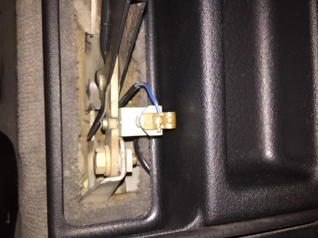

          So i put the little spring thingie on everything fit but now i can't put the ebrake boot on. I dunno if the m3 one is different or if i have it on wrong. Found out the other wire there goes to a light bulb for the ashtray so i fixed that too. I'll try to post a pic of the spring sensor so u can see what i'm talkin about

                This is what it looks like now, no room for boot. I must have put it in wrong
                • vpilarrt
                  • Jun 2006
                  • 2096
                  The little 90° bracket should be mounted to the driver's side of the handle. In other words the screw goes in from the passenger's side, not the driver's side.
