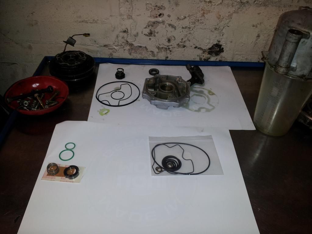

                        So I rebuilt the compressor last night after work with parts from Polar Bear.
                        In the picture at the back of the bench is the face the carbon seal works on. I decided to linish this smooth with 1200 wet and dry as it had some fine grooves in it.
                        I also decided to keep the carbon seal dry on installation as to let the seal bed into the face.
                        I have found very little information on this accept a member here who has been great.
                        Next is to bolt it up, vac it down and if no leaks then gas it up and see....
