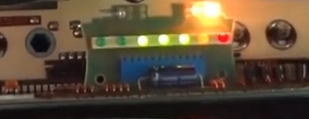

    Did any one of you guys have this happen to you? The service indicator light is partially working in my car. The very first 2 lights are not on for some reason.
    Tried searching the interw3bz but I couldn't find anything on this.
    See image as to what I am struggling with.
    See the first two green lights not being on? The SI was reset properly at last service, but even before that the lights weren't on. They were the same, first 2 bulbs were out.
    Any help is appreciated.

    Try cleaning the contacts on both the SI board the LED panel. Corrosion or oxidation is common on these old electronics, esp those with battery acid leakage.
    If that does not work, if your Si board has not been refurbished, you need to have it refurbished.

      I think it will need refurbishing. I cleaned the contacts already.
      Damn it.
