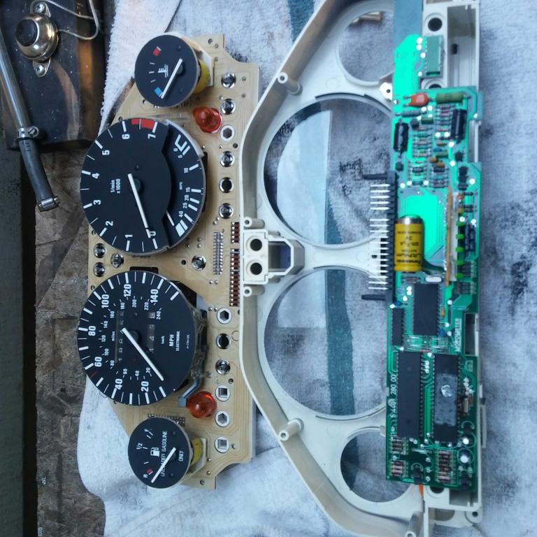

          Any Idea how to check a tach input . . I Have tried multiple Tachs in the original Cluster and have now tried multiple clusters. So I need to start chasing the problem but I have no idea where to begin.
          • jake5
            • Sep 2014
            • 83
            Just pulled SI boards on both my clusters. battery is are dead in both. First pic is a vdo with motometer SI board.Click image for larger version
ID:	7177895 Second is motometer and original to the car. Note difference in batteries.
            Sent from my LG-H631 using Tapatalk
            • jake5
              • Sep 2014
              • 83
              Adding correct second pic
