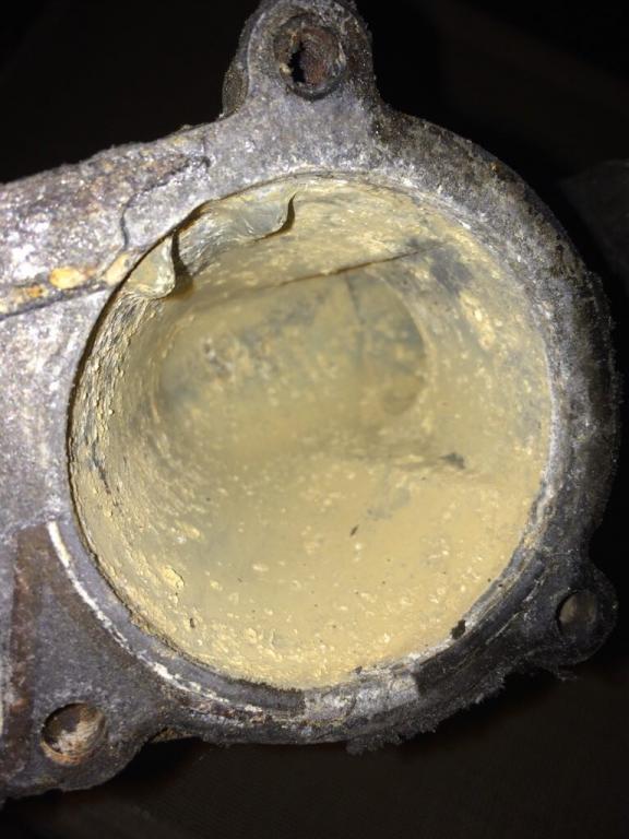

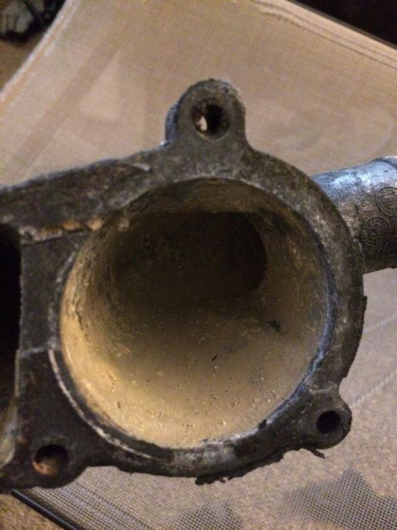

Nasty stuff inside of thermostat housing
  • Th3importedguy
    • Mar 2014
    • 190
ID:	7243853Click image for larger version
    Wtf is this. There a puddle of it under my IM.
    E30 is life :finger:
  • TobyB
    • Oct 2011
    • 5297
    That's why it's a good idea to change your coolant every couple of years.
    And use distilled water.
    It's iron oxide and aluminum oxide and dead coolant....
    t
    • 97audia4
      • Apr 2015
      • 29
      get some mineral spirits and clean it out
