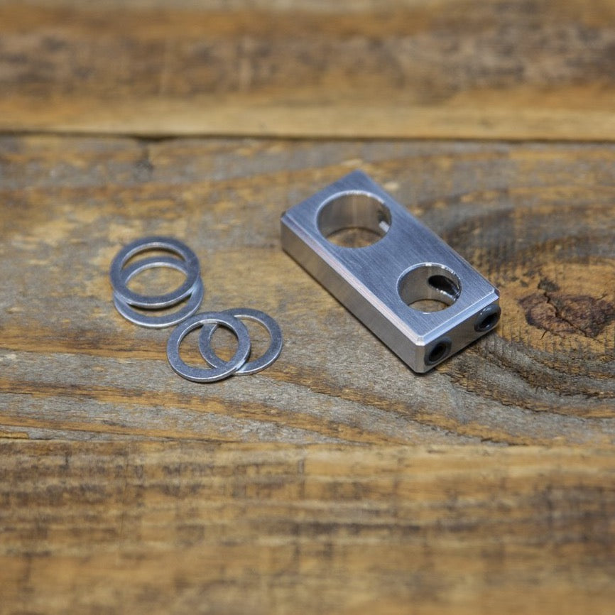

                    Nope it's just this urethane block that basically lets you take out all the PS crap you don't want but maintain air and fluid flow through the rack. If my water pump gaskets are here today I will almost definitely make a write up to go along with the one on e30tech
                    Tailored for track and street builds, this aluminum power steering delete kit enhances steering response, reduces weight, and upgrades engine bay simplicity.
