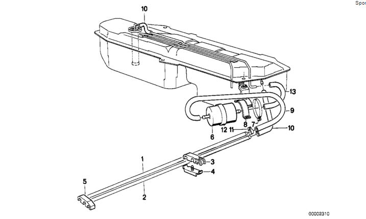

              Eddie, I know you posted you response to this a while ago, but I'm curious about your point below:
              7. Leave the rubber fuel line end connected to the tank. You will be working from the other end of the fuel line which you disconnected.
              From the attached picture, are you suggesting I disconnect #2 and #10, and then thread the frayed wire through #10 into the fuel tank? Why not just disconnect #10 directly from the fuel tank and go right in?
