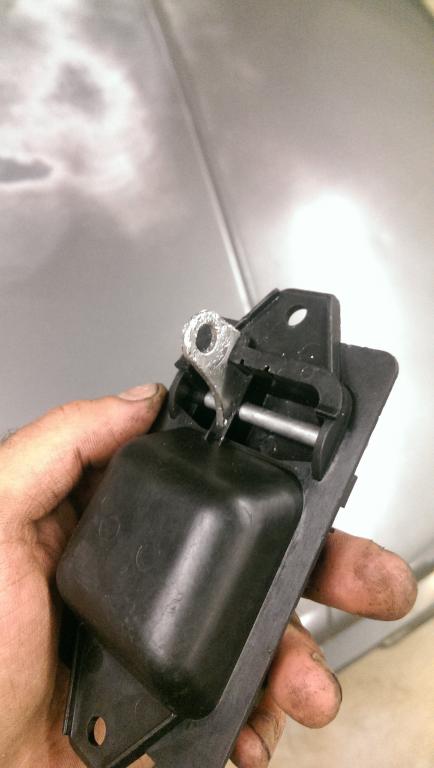

So tonight I went and tried to install a new release lever for the convertible deck lid. The car came without a lever and just the two loose cables. PO had been using a pair of pliers individually pull the cables to release the deck.
I bought a new handle and went to try and mount the cables to it. Thought I had it but then the deck wouldn't release. I tried taking the new lever off and pull the cables again but no luck.
Looking at more diagrams, it looks like I need more of this handle than I got from Pelican. Thoughts?
No most importantly....how do I release the deck lid now that the release cables won't do it?
