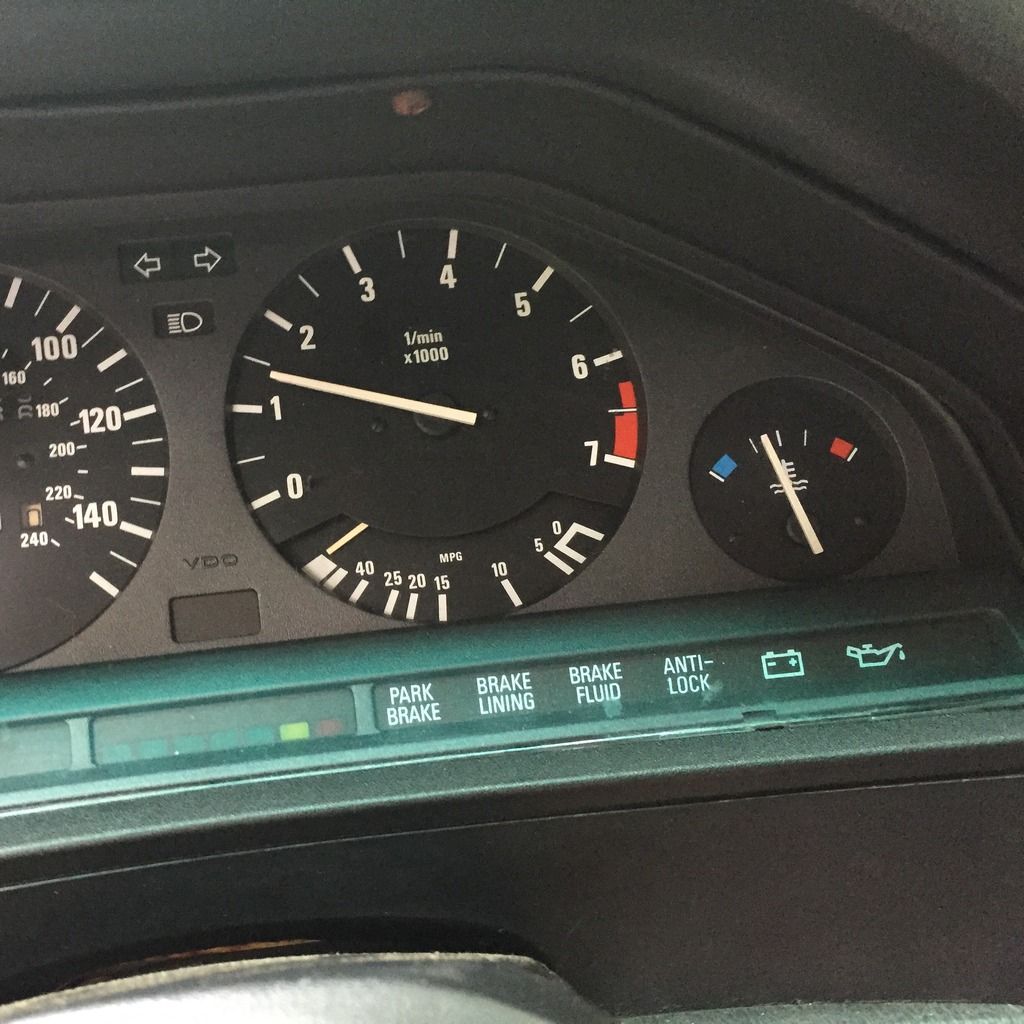

Best way to diagnose overheating issue?
  • e30onBBSs
    • Dec 2014
    • 1347
    I finally got my e30 running with no problems besides my overheating issue. I replaced the thermostat and I just did the timing belt and water pump. My car had no fan when I bought it and I got a brand new fan clutch and fan. When I drive it it slowly creeps up like a normal car does, then it stays at 1/2 for enough time to give me hope then it goes towards the red. I really don't think it's a blown head gasket, there is no stuff under the oil cap and the exhaust is fine. Could my gauge be lying? I bled the system with the thermostat "drill a hole" way, and when I turned the car off I could hear bubbles coming from the radiator, which seems like a good sign. My heat doesn't work. The water pump/alternator belt is a bit loose but it spins fine. A friend in France gave me a new expansion tank cap as well. Any ideas?
    I've been doing lots of research and many times it's been people's radiators. They said to get an infrared thermometer and scan the radiator for cold spots. Is this a good investment?
    One time my car over heated pretty bad, but I have no tell-tale signs of a blown HG. It was left at idle as I was trying to get a sticker and then it was like shit it's smoking coolant. Should I test the coolant? Would there also be driveability issues with a blown HG? It runs like a champ and idles great and healthy besides this overheating problem. Would there be misfires or something?

                      Hey guys thanks for all the tips again. The problem is solved!
                      A guy who was selling e30 parts in my town came and helped me out. I thought I bled it well, because I did the thermostat hole, then pump it until it flows through the bleed screw, then tighten the bleed screw, and keep pumping until it reaches the overflow. It seemed to work, because most of the time it was burping air at the expansion tank, and it took a lot of coolant.
                      The craigslist guy's name is Parker and one of the first things he did was feel the upper rad hose, and I assumed it had coolant the whole time, but it was just air. He suggested we undo the side of the upper rad hose that attaches to the thermo housing, and we filled it up into the upper rad hose, then put it back onto the thermo housing when it couldn't take anymore. We kept bringing it up to temp, and slowly it kept creeping up past 1/2. Then we jacked it up and tried the same thing with a different hose, and had the same outcome. It was still overheating, and the hoses didn't seem to fill. We were both stumped and he left because we didn't know what else to try.
                      After it cooled down, I felt the upper rad hose again, and it still felt empty. When I took it off the thermo housing, the thermo housing was empty too. It was time to start trying something new, so I took the upper rad hose off, and poured in coolant/distilled water. I then started squeezing random hoses, and squeezing them with the expansion tank open would lower the coolant level in the upper rad hose, and cause bubbles in the expansion tank. This was a great sound, and a great break through because the upper rad hose kept taking coolant as long as I kept squeezing the hoses. The main hose I squeezed was the hose on the right side of the thermo housing, it is the one that connects to outlet that bolts to the real thermostat housing with three bolts. I kept pouring and squeezing until it would overflow out of the outlet that the upper rad hose connects to on the thermo housing. Then I took it for a drive, and it went a bit more than twice without creeping past half~ 2.5km. My neighborhood is about a kilometer circle with some cul-de-sacs, and I did two laps and one cul-de-sac. I got home, as she was at about 3/4, shut her down and waited until she was cool. A couple hours later, I took off the upper rad hose from the housing and there was coolant in the thermo housing but again, the rad hose was completely dry. I did the same process as before, and this time it didn't take nearly as long until the upper rad hose and the thermo housing were full of coolant. I left a couple inches of the upper rad hose empty so when I had to put it back onto the outlet it wouldn't spill everywhere.
                      I did this filling as it was getting dark, and I had to clean up my tools and what not so I was like ok I will wait until tomorrow. I got up this morning and drove it about 6 miles and it was a tad below 1/2 and stayed that way from about mile 1.5 on. It was so awesome when that needle stopped, where it normally keeps going!!
                      Thank you guys for giving me ideas and just being able to read some responses really helps channel my thoughts and get new perspectives. You guys are the best!
                      the tstat is a few degrees below stock, but for now it's great compared to what I had been dealing with. :)
