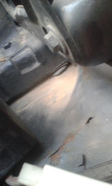

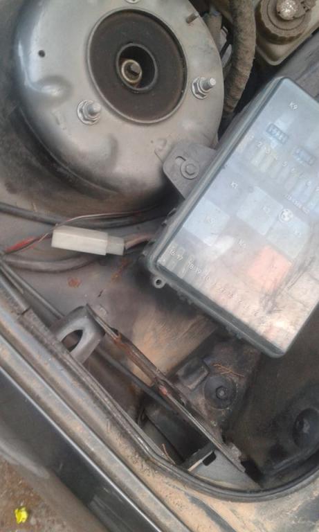

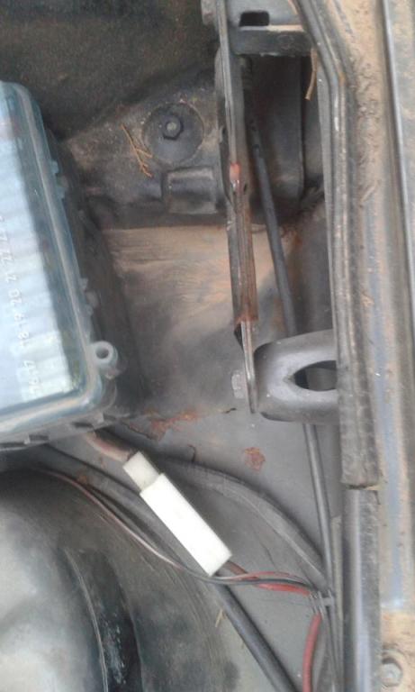

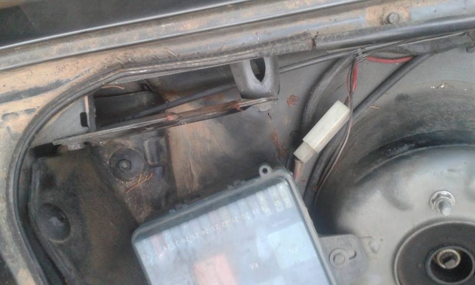

    Hello, i hope its the correct forum for this subject.
    I have E30 325i euro version, with some suspension modifications:
    -KW Sport shocks
    -KW Sport springs (40mm lower)
    -E90 drophats (10-15mm lower)
    -IE eccentric wishbones (RACE purpose extremely stiff)
    - stock sway bar
    - Z3 steering rack
    after two years with this setup, it became too much stiff, on some serious bumps i felt it hit the chassis. after a while i noticed some dent under the firewall near the fusebox.
    my qusetion is what you think сaused the damage? race stiff wishbones? e90 drophats? its felt like the shocks but they are in a good condition.
    someone had the same experience?

                it is common for e30. Too much hits to that strut tower with bottoming out of the wheel + corrosion + most likely the car had a collision in the past.
                I'm pretty shure it is a crack, not a dent.
