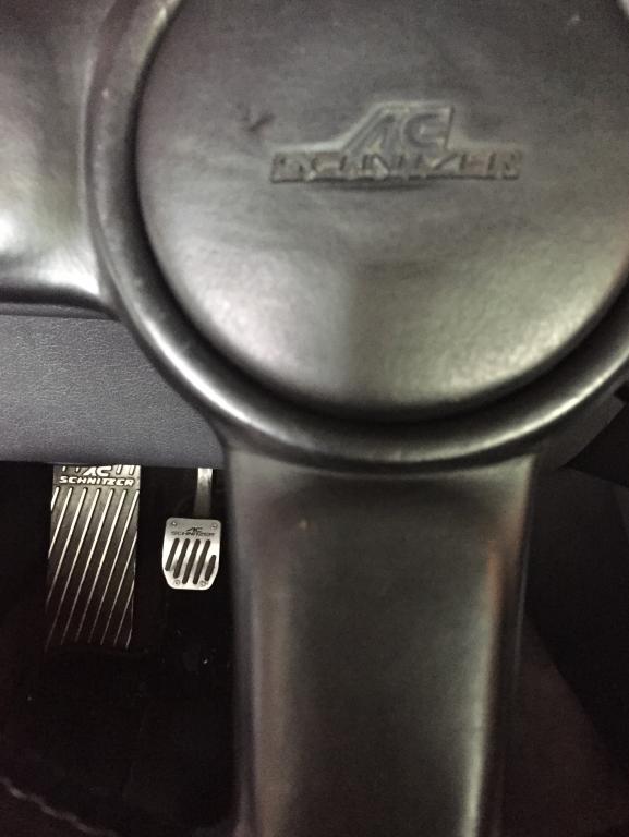

                  Great thread. I was able to cannibalize the part from a spare mtech. Did the trick and love the wheel. Now I just need the matching shift knob.Click image for larger version
