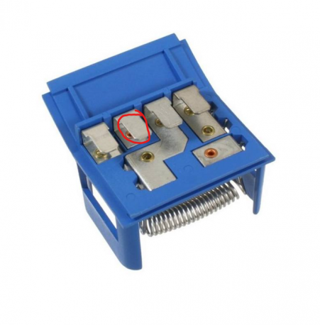

          Resurrecting a 7 year old thread since I just went through this lol. Cleaning the connectors fixed the issue for me as well. These are the connectors to be cleaned:
          As far as testing, you can test for continuity from this pin (red) to any and all of the other pins. If there is no continuity, those tiny contacts above are not connecting and should be cleaned.
