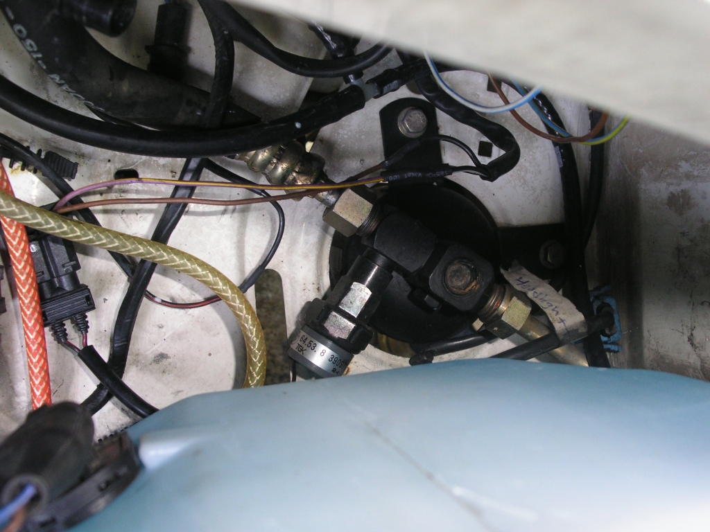

            • rs4pro3
              • 5808
              here you go
              85 325e 2.7 ITB'd stroker

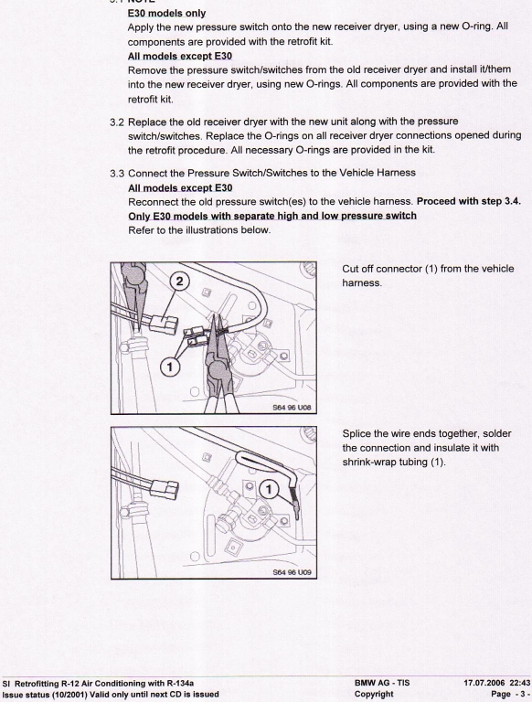

                • rs4pro3
                  • 5808
                  No, you cut the plug of the high pressure switch wiring, and splice those 2 wires directly together. You then cut the plug off the low pressure wiring and install the new style plug. Then plug it into the new pressure switch. R134A runs at a higher pressure, so on the e30 BMW calls for bridging the high pressure switch(ac won't cut off if pressure get's too high), then they installed a new low pressure switch which cuts off at a higher pressure.
                  Here are some scans of the TIS documentation.

                        I think mine might be backwards. I have my high pressure switch where your low pressure one is coming out of the side. It also looks like your high pressure line is on the opposite side of mine. My solid line comes toward the receiver/dryer from the firewall.

                        • rs4pro3
                          • 5808
                          the location on the 318i may be different, that pic is on my 85 325e.

                              • 14396
                              damn, i was just looking at it wrong. it's the same. So I should just plug where the low pressure switch went and then put the low pressure one where the high pressure switch normally goes? that's what it looks like you've done.
