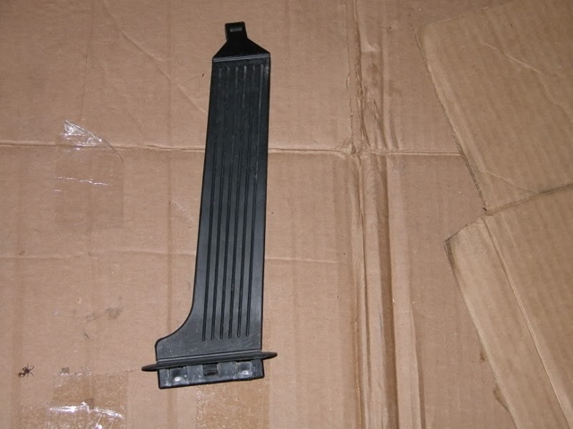

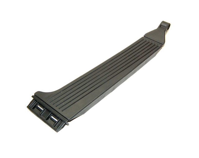

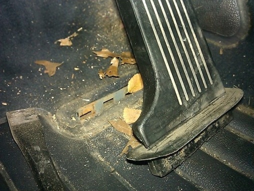

    I recently ordered a new gas pedal for my e30 and I realized after doing a little research that there's two different variations. One type has a larger plastic trim that looks like it holds the carpet in place, while the replacement one that I have and what was previously in my car does not have that. There is a gap in the carpet where crud gets under the carpet and collects at the metal gas pedal bracket. I cleaned up some surface rust but I was hoping that the replacement pedal would have the carpet trim.
    The one with trim:
    New replacement no trim:
    New replacement w/trim:
    I ordered one from blunttech but I found this on eBay:
    http://m.ebay.com/itm/New-BMW-e30-31...849?nav=SEARCH
    if anyone knew why the differences are there and if there's a different part number, please chime in!

    I thought it was a change with the facelift- I have one of each, one from an 87, one from a 90....

      Are they interchangeable?

        I looked on realoem and the p/n is for 88 and later.
        P/n for post 88:
        35 41 1 156 488
        P/n for pre-88:
        35 41 1 118 210
        Both parts are listed as:
        Superseded by:
        35411156488 (07/08/1988 — ), nonexchangeable retrospectively
        Part 35411118210 was found on the following vehicles:
        3' E30   (12/1981 — 05/1993)
        5' E28   (09/1980 — 12/1987)
        6' E24   (09/1977 — 04/1989)
        Sent from th
