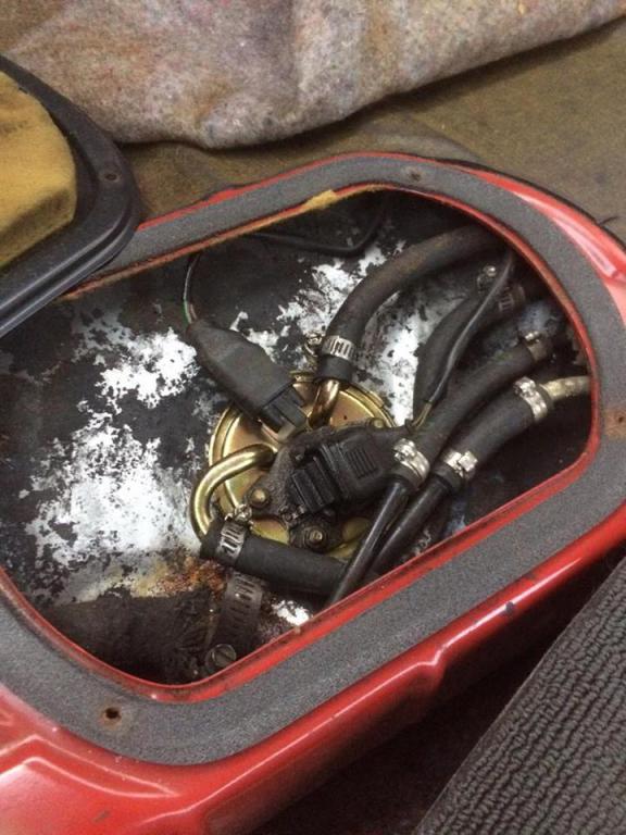

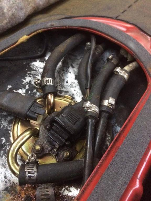

                      *udpdate*
                      So i went and jacked the car up today for a better look and took off both covers in the backseat. Ive never dealt with fuel issues before so nothing really came to mind of what the problem may be yet. From what it looked like corrosion on the fuel tank didnt seem to be a problem which is some good news. I took some pictures so you could get a better look at the problem:
                      Heres what it looked like under the cover on the passenger side
                      There did seem to be some gas residue on the top of the fuel pump but not significant enough to cause the amount that was dripping.

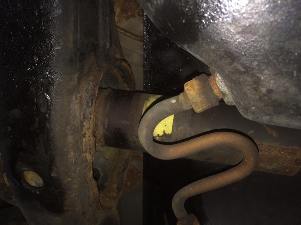

                      Heres what it was like from underneath. Sorry about the clarity of the pictures it was awkward underneath to take them.

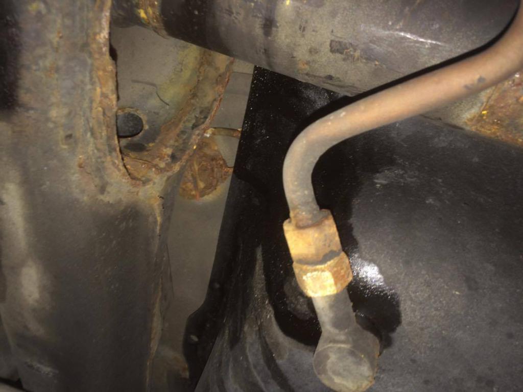

                      The top right is the fuel tank on the passenger side, the gas doesnt seem to be coming from the fuel tank its self actually. Not sure what the curly piping going into the tank is called, but it looks like its leaking from above it , from where is starts on the the driver side. From driving, the gas leaking flowed from towards the drivers side to the fuel tank and dripped off of it. As you can see it looks like its coming the left side of the piping on the drivers side and not where it goes into the tank in the top right.
                      This is a better picture of where the leak looks like it starts above the pipe towards the driver side
                      Any info will help! Need the car back on the road ASAP

                      • george graves
                        • 20003
                        Did you run the pump while the covers were off?
                          Yep, pump wasn't the problem I don't think. Nothing came out the top when it was running. I think the residue is just from a little seepage over the years

                            Okay guys last update! I decided to drive my car around my drive with the cover off the backseat and saw that it overflows from the top, around the fuel pump when I move and the as splashes! Leak located, I think it would just be the o-ring around the pump that needs replacing them I'm assuming
                            91' 318is Brilliantrot
                            Yes, it still has an m42
                            • roguetoaster
                              Biggus Tippus
                              • 7830
                              Yep, that's the normal failure, auto parts stores might even have the part in stock.
