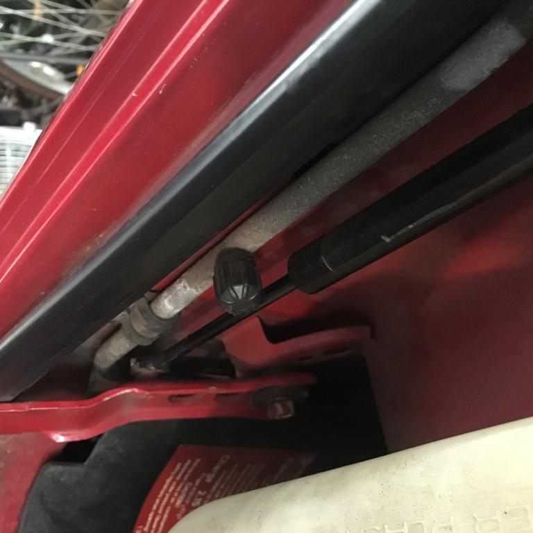

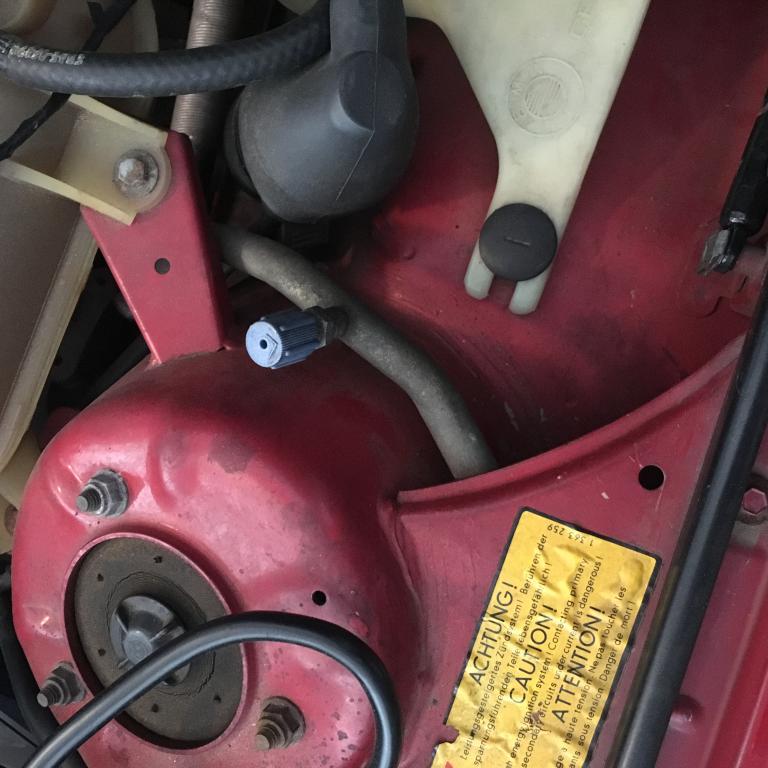

    Trying to refill the R12 in my e30 but i can't figure out which port is the low pressure valve. Help!Click image for larger version

      The blue one with the "L" for low pressure, but it looks like you have r134 adapters on there

        There is also a port near the headlights when you take the plastic panel off

          My bad i actually have R 134 a. Forgot they switched it. So the blue L is low right? just want to make sure so the can doesn't explode

                  That's your dryer. If the system is empty you need to change that too and pull a deep vacuum or you are wasting time and money. Otherwise ignore the dryer and top up your r134a at the port with the blue cap. It's the smaller of the 2 ports.

                    Yes L is for low.. the low side is near the shock tower

                            The high pressure port is the black one in OP's second picture
