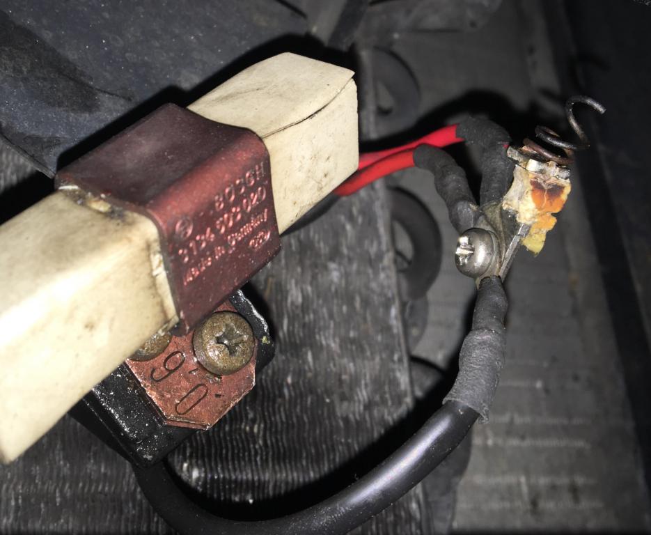

                    My resistor has 3 wires; 2 red and one black. While battling the frozen screws I destroyed the resistor, so I just connected all 3 to the broken connector as shown below:
                    Is this the way to do it? My condenser aux fan still doesn't come on when the AC snowflake is lit up (blower comes on low speed as normal), but when the radiator switches are jumped the relays kick and the fan runs on both speeds, so I know it works (I replaced fuse 3 with a 30 amp ahead of time). I'm not getting voltage at the pressure switches, but that's another story. ;-) From what I've gathered the aux fan should run even if the A/C control regulator/relay is defective.

                      you know your fan works so it's almost certainly wiring. I'd take those resistor wires apart and check polarity and voltage with the key on, off, ac on/off, then run a continuity check from the high and low fuses.
                      That should narrow it down
