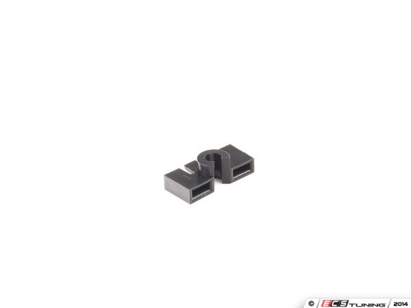

        once you get the sunroof panel off you might find that the rear rain gutter is just pushed back into back and in the area above the rear seats. the rear gutter is pulled forward by the interior sunroof panel. Often times, the plastic clip (image below) that connects the two break and the gutter no longer gets pulled forward.
        maybe its the part you ordered and are waiting for, but for reference, the PN: 54121934933
