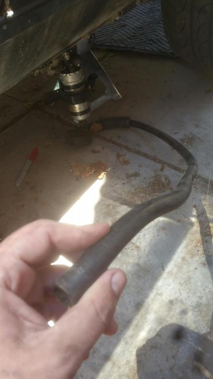

    gas tank install help.
    so i got a 84 325e that had been sitting for quite some time. The car had a rusty gas tank that needed to be replaced. the previous owner disassembled the fuel pumps prior to me getting the car and never reinstalled them. i went ahead and dropped the exhaust and driveshaft and pulled the old tank. Now that i am ready to install the new tank i cant remember where this hose goes and what it connects to? any help with be appreciated. thanks in advanced.

    I think that one goes up top the tank and comes down the driver side. Connects to the fuel pump then goes across the fuel tank to the driver side.

      Thanks you were right. I was able to route the hose on top of the tank to the pump under the seat. Car still won't start so next up is check the pumps to see if they're working
