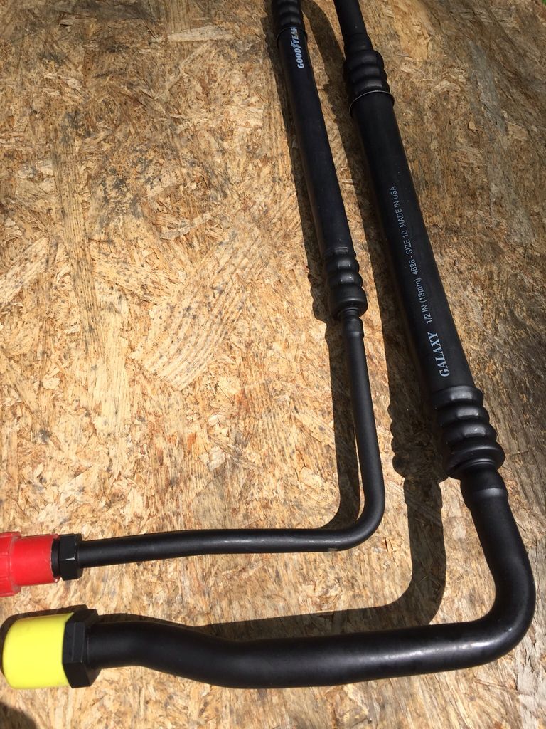

            Here are the 2 hoses that go above the glove box. They were NIB but I still had them refreshed with barrier hose for about $80 formthe pair and that included shipping both ways. If you look closely you can see where they sweated the ne crimp fittings to the original steel pipe. Very nice work.
            The reason I did that was after doing a complete system upgrade (see my Cabrio build thread) i had to top it up a couple of times each summer. This year it wouldnt hold a charge for more than a few days. The problem was those 2 hoses which were the only original parts I kept were leaking like a sieve along the full length of the rubber.
            The EPA says non barrier hoses in converted systems may do ok because they are saturated with mineral oil. I suspect what happened to mine is that any remaining mineral oil got flushed out so I was left with porous non barrier hoses that had to go.
