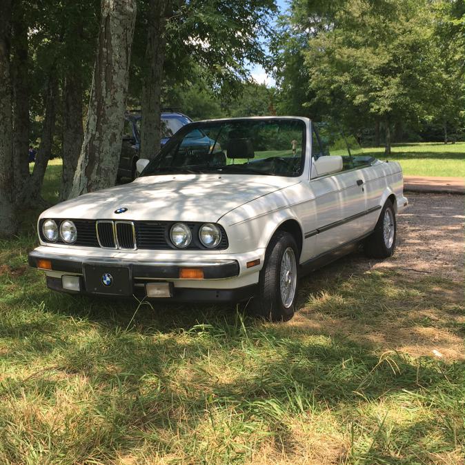

    Just purchased my first BMW, and I am very excited to join the family. Been wanting an E30 for a few years now!
    Here are some details:
    - 1992 BMW 325i Cabriolet
    - Automatic transmission
    - Almost completely stock
    - 107K Original Miles (Odometer Working)
    - UPDATE 11/20: Now at nearly 116K miles!
    - Retractable roof non-functional (manual only)
    - Owner told me I should probably have the timing belt and an alignment done soon
    - Idle is a little bit rough, so I'll be getting a tune up alongside the timing belt
    - All power windows, buttons, etc work, save for the retractable roof.
    - Front seats have been recovered. Very well done, I may add.
    I paid $3,900 for it.
    Some pictures:
    Discover the magic of the internet at Imgur, a community powered entertainment destination. Lift your spirits with funny jokes, trending memes, entertaining gifs, inspiring stories, viral videos, and so much more from users.

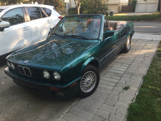

    Nice. Here's my similar 92 that I picked up about 4 months ago. It's stock with 164k miles. Since I got it, I've done the following:
    * timing belt/water pump/plugs/rotor/etc.
    * reupholstered seats (leatherseats.com)
    * converted broken automatic top to manual
    * new(ish) top

        Yeah, I ordered the 91 model. They called to confirm everything, and it all fits great. I did the install myself over a couple of weekends. It's not hard, just get some good sharp wire cutters!!!
