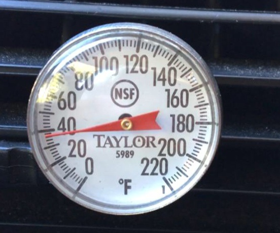

                        Also just letting you know. There is no such thing as just needing recharged. AC is a closed system like a cooling system you don't just loose coolant for no reason. If your ac isn't blowing cold you have an issue. Could be clog somewhere or a leak in the system.
                        You got that right! My nonworking original R12 A/C on my '86 hadn't been touched in at least 20 years, but still had positive pressure in the system. I haven't had a chance to diagnose why the compressor and auxiliary fan don't come on, but when I applied direct voltage to the compressor I saw white bubbles in the sight glass which went away after a couple minutes. With the auxiliary fan not running and the interior blower at 2nd or 3rd lowest setting, here's the vent temperature (with the outside temperature approximately 75°).
