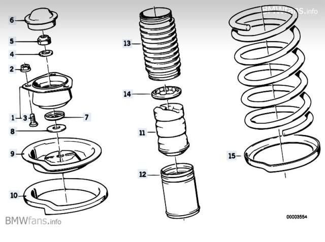

      I have an interesting theory.
      If the front shocks where replaced and #8 in this diagram is missing the steering does funny things in regards to returning to center. First hand experience.
        Yup i have the same issue, and i know for a fact that i forgot to put it back in on one side of my car. When you make a left or right hand turn it also wants to go left or right while you drive until you hit a bump or something to relieve the pressure from the top hat.

                FYI, sometimes you need two #8's to give proper clearance for the spring hat not to rub on the strut mount. Also, don't forget #7 as this keeps dirt and junk out of your strut bearings.
