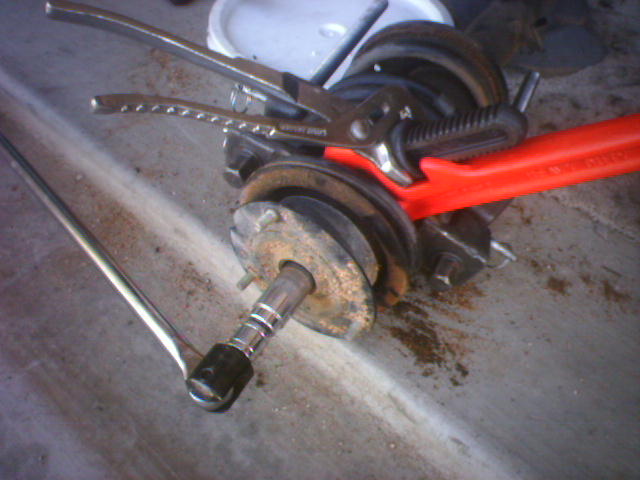

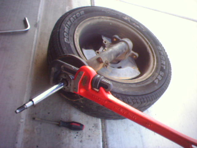

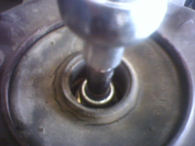

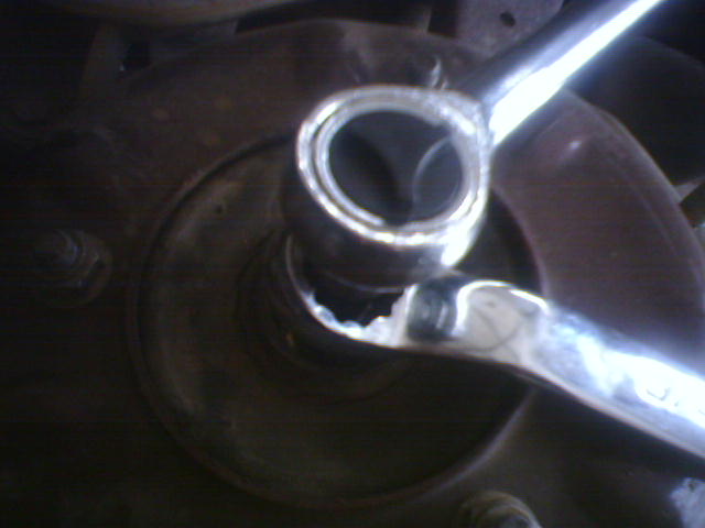

    Its impossible to unbolt on the top of shock's bolt. Can you give me instruction how to do that.

    are you replacing it? if so pull down teh dust boot and toss some vicegrips on the shaft to keep it from turning.

      Yes, I am about to replace new shocks. I used plumber wrench it didnt hold.. GRRRRRR

            impact. and or hack saw. i used a hacksaw on a strut once, didn't take but 5 min.

                  impact gun is the best. if not soak with pb blaster and put vise grips on the shaft.
                  • Gus
                    • Jan 2004
                    • 285
                    stiltson wrench on the shock shaft if you arent reusing it (can be done even if you are, but pretty nasty)
                    else hold the 19mm socket with vice grips and turn the 8mm...a lotta pressure for a small socket though
                    rattle gun is the best way...by far. so easy

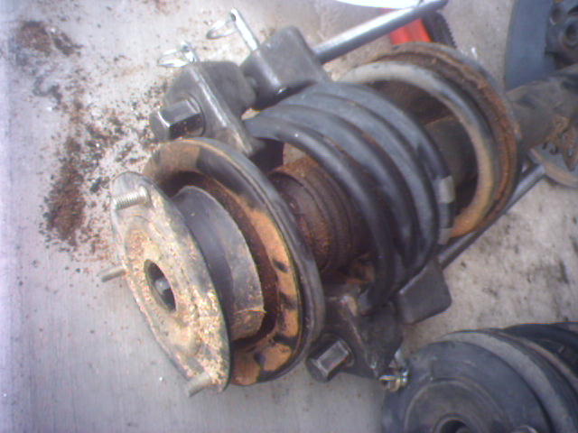

                        Never mind about this. I found a way to make plumber wretch tighten. It worked. Whew.. I finished work on shocks.. Thanks!

                          Since it's already been said a dozen times, impact wrench. The cheapie 70 dollar one from Harbor Freight does the trick nicely.
                          Having done suspension both with hand tools & impact, there's no comparison. Impact wrenches made it ridiculously quick & easy.
