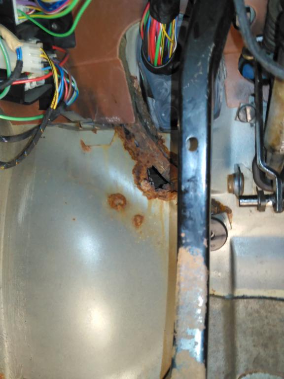

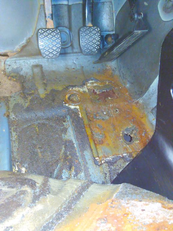

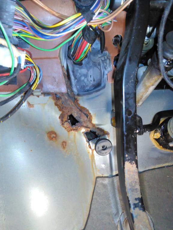

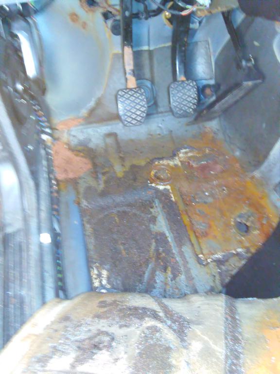

    So...I've got several specific questions regarding some rust in both my drivers and passenger side front floor, and I also a tiny bit of rust on the drivers side where the firewall meets the well. I mainly want to know peoples opinions on the firewall rust. I've already got the subframe pulled (along w/ control arms, sway bar, steering rack, etc)
    I know I didnt add any pics of the passenger side floor. I will when I have a chance, but for now I'm primarily concerned about the driver's side

    Firewall rust, is it fixable?
    If so:
    -how many/which components in the engine bay will I have to remove?
    -can I just cut a generous part out from the inside and weld stock of a similar thickness in?

    Floor rust
    -Im assuming its fixable, given what I've seen other people fix on here
    -what gauge do people usually use for the floor? otherwise I can figure out myself
    -do i need to add in a drain?
    -when people usually repair this do you all remove the carpet completely? cut out the general area and patch it back in later?
    -when people get "soggy" or "wet" carpets do they usually replace that section? the whole carpet? or does it dry out just fine?

    Looks like you still have sound deadening on the floor. You need to remove that to determine the extent of the rust. On the firewall, you need to see how bad it is on the other side.
        Everything in the way needs to go, along with whatever sound deadening is in the area.
        If you get everything removed from the opposite side you can do the repair that way, though you'll want to protect both sides of the repair with rust prevention coatings.
        I've typically recycled West German sheet metal from old fenders.
        I wouldn't unless you want it as close to original as possible.
        You definitely want to remove the carpet. Leaving it in will only make the job harder.
        Unless it's gone mouldy the carpet will dry fine and can be reused if it's not too worn.
