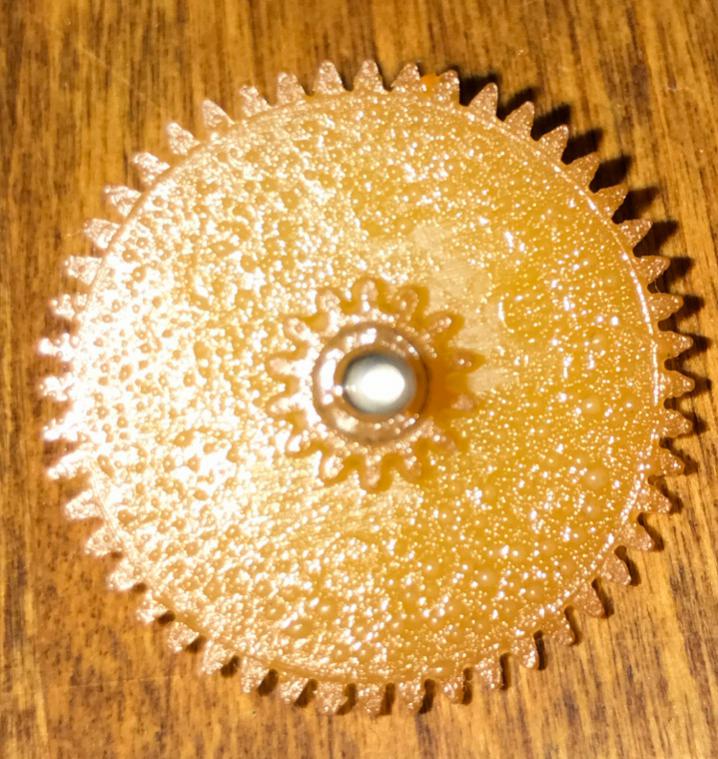

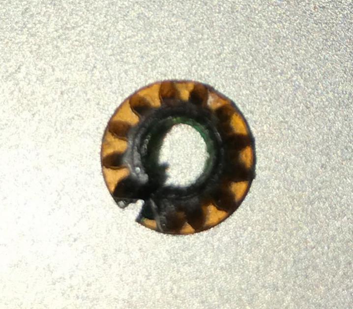

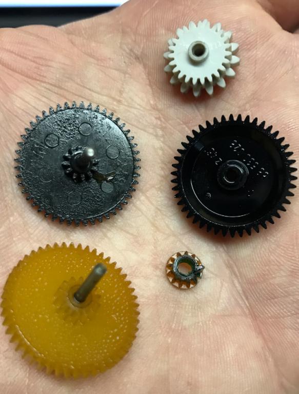

    While I had all this out I am also going to fix the stripped odometer gear that caused everything to stop rolling. But for the life of me I cannot figure out what replacement gear I need to buy. The tiny main drive gear is pretty badly stripped and cracked so I can't be confident the number of gears I count, but I think there are 12. But on the smaller inner gears on the larger gears I count 14. Should these match or does 12 and 14 sound right in other experience? I attached pictures of the gears below.
    I must say I'm surprised at BMW for making something so poorly marked that you have to count gears. I figured they'd put a number on the gear or something. Well hopefully someone knows what the hell I'm talking about, even if I don't - thanks!

    You spec the gear set by the mfg of the speedo...VDO or Motometer

      As far as no ABS indicator spot on the cluster, it sounds like you may have an early model cluster in your car. IIRC, ABS was not added until the 1986 model year.
      There are several vendors that you can buy the odo gear set from. Most sell these in complete sets of four gears, and they are reasonably priced. Replacement is not too difficult.

        Yeah I just went ahead and ordered a gear set that I think matches what I have - I'll visually confirm when it gets here. Its a VDO cluster.

          For the odometer gears, as mentioned, you want to buy a whole set and replace all four. I just did mine with the Garagistic kit. They only go in one way and there are plenty of videos on youtube showing how to do it right.

              Yeah the kit I bought is the Garagistic one, should arrive tomorrow so I can put this thing back together and get it back on the road again. Hopefully with an ABS light too if I can sort that part out. Thanks for all the help!

                    Success! All my dash lights work AND my odometer is rolling again! Made no difference in my ABS issues, but its one more thing off the list. Thanks!
