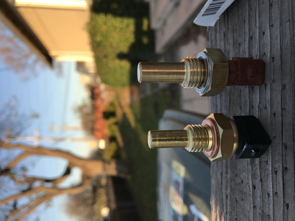

      I replaced the 1 prong sensor (should be coolant sensor). the 2 prong sensor i cant find. i bought one (for $200) and the threading was wrong so it didnt fit. id love to hear if anyone know where i can get one that actually fits. the one i bought said it was for e30s but it was too thin. see the picture

                  • Kershaw
                    • 11822
                    so...
                    1. list your make model year (do that in all future help posts too)
                    2. the 1 prong temp sensor (brown) is for the cluster. the 2 prong temp sensor (blue or white) is for the DME (cars computer). The blue/white one is the one that would affect the engine. It should be less than $25.
                    3. Try blunttech, fcpeuro, amazon, or ebay. Just google e30 temp sensor.

                      Originally posted by Kershaw
                      so...
                      4. get familiar with realoem.com
                      5. https://www.fcpeuro.com/products/bmw...sor-0280130026
                      Sorry guys. you are right. i should have mentioned that the car is a 1986 325ES. as for coolant sensor is concerned, i have already replaced that. didnt do much

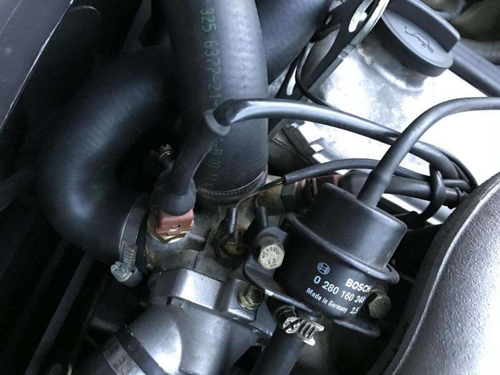

                        so...
                        In my pictures i think that white sensor closest to the intake is what you mean, correct? that i have not replaced. ill give that a shot.
                        • cscracker
                          • Jan 2017
                          • 131
                          Here's a picture of mine:
                          This is taken from the passenger side, the blue one is the one for the ECU, brown one is for the cluster. My car only has two sensors, and the other two holes have plugs in them. Your car has four sensors in the thermostat housing, so I'm not sure what the other two are for.
